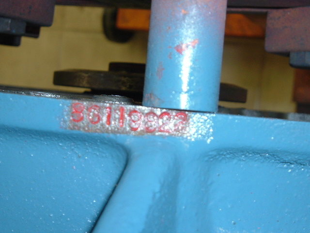

Have you looked for a VIN number on the back of the block by the oil sensor sending unit?
What is the engine assembly date on the front pad of the engine?
68 engine with the HP is a good block. if no VIN then an early 68' model year engine. At least the date on the pad by D440 will get you closer.
