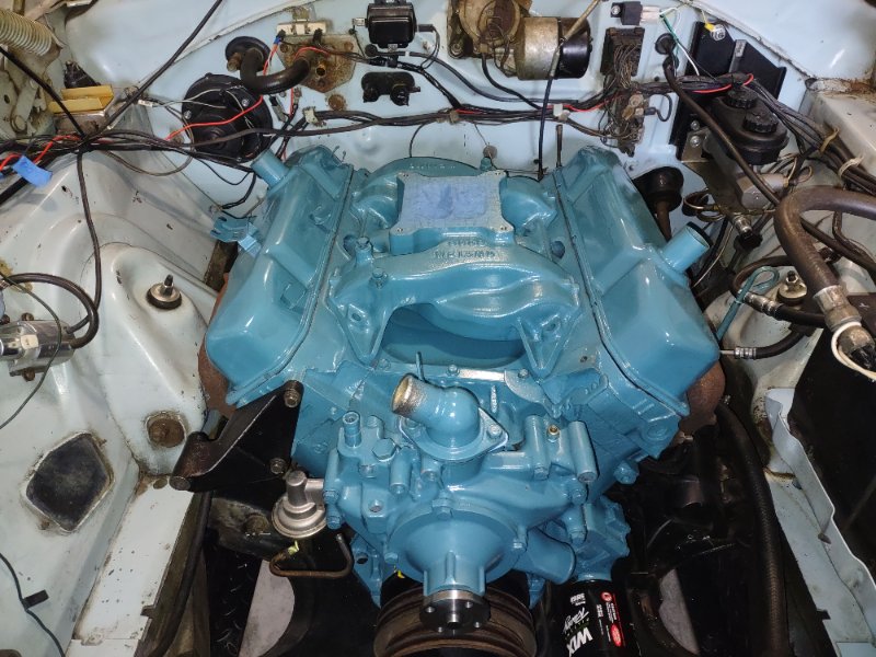

Been searching for a 440, only found a couple but they’re claiming fits chevy and dodge…. Which i have NO trust for…
as always, appreciate in advance
Your looking for a bolt center of 83mm. I like Flashpower o-ringed thermostat housings. Top hose 1 1/2"? Didn't see a 45° one available, but in the site, you can ask a question. Reply in 24hrs. Yeah, it's made in China. Should be available in black and clear. I have 2 of the straight ones on my cars and like them.
If this is the 45 degree housing you are looking for, they only came on air conditioning cars. I am not aware of anyone reproducing them.
