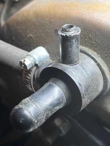

Do you have power brakes? Disconnect booster and plug line.
Vac leak,had that problem on my 318 and chased it thinking it was something else.
Guys! You are the best. Finally found it! It was indeed a vacuum leak at the brake booster...
What is your vacuum gauge readings ? That's the first thing I'd do when you brought your car into my garage. { Edit: sorry, didn't read all the posts, only the first 2-3. But you did post in #1 that you checked for vacuum leaks. This is one of the first things I learned as a kid 55+ years ago in the garage. }
I kept saying to myself this feels like a vacuum leek. And indeed it was, I just did not check that booster connection like the other guys said. I even think I know what happened. The last thing I did before the problem started was check the master cylinder. I probably knocked that plug off when I was wrestling the master cylinder top clip thing off. Vacuum at idle was 15 inches.
