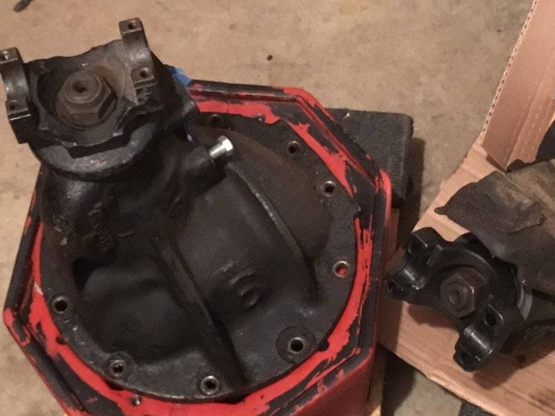

Found the shim under the yoke gouged and in sad condition. New shims weren’t exactly the same size but I use them and tightened it down as near as I could to the previous torque. Just wanted to give an update.

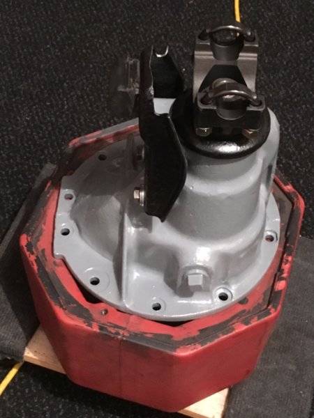

Don't like the color I painted the chunk- thought it would be darker.
the shim you found under the yoke has nothing to do with pinion bearing preload - it is factory installed washer so the yoke does not gouge into the bearing when you tighten down the yoke to establish bearing preload on the crush collar between the front and rear pinion bearing -- to add shim to the top of the crush collar you have to remove the small bearing under the yoke .

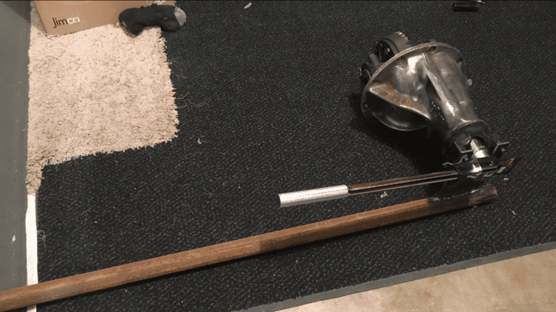

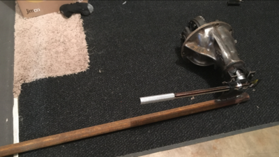

By the way, here’s an easy way to negotiate the nut. Special tool I welded to hold the Yoke.
You can use it while the chunk is on the car also.
