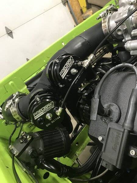

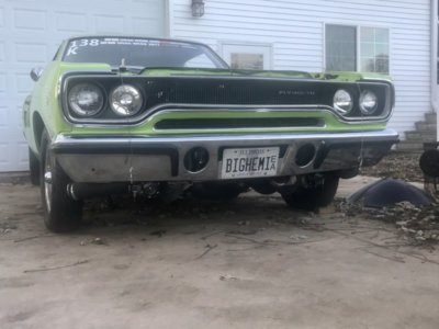

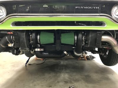

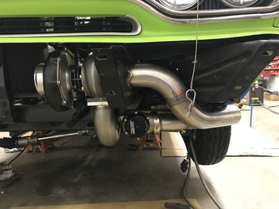

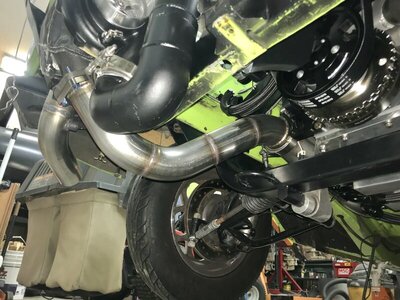

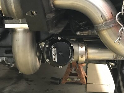

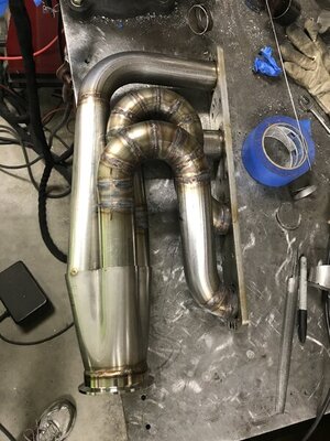

Nobody makes a kit for twins in any of these cars for any engine to my knowledge. Not a 5.7 but here’s mine.

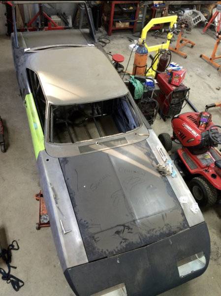

It’s actually a black Superbird from a video game. Random pick I found online. I like it cuz I’m building a black Superbird.
Cool I have a friend that had a real S.B. he painted it black and where it should say Plymouth it said black ice (that was his band) Well known bird. I know he sold it and it wound up down south (lol) somewhere.
He is a great person and very knowledgeable on Superbirds and most Mopar's. He was awesome help when I built mine. I don't think I could have finished it with out his help and advise.
any issues with your turbos down low there and the air inlet down there? I assume you never drive it in the rain or chance of rain? My Fury is twin turbo and I'm working on a single turbo 5.7 in my Coronet now.
With all the disasters of 2020, it has yet to run. Work has been in overdrive and hobby has been idle lol. I just got an ecu so I can finish the wiring and be out later this month. They make water resistant filter covers for these but for the most part, it’s a fair weather car. Post up some pics of both of your projects.

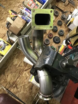

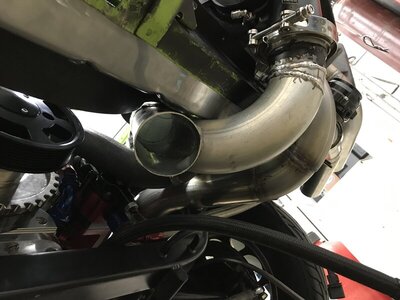

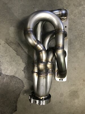

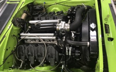

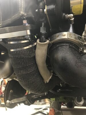

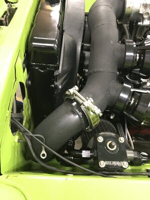

I love seeing the turbo mopars. Not a lot of em out there compared to other brands. What do you want to see? Routing was a PIA as I didn’t want to hack the car. It has a dry sump system under the drivers fender and a puke tank under the passenger side. I couldn’t fit in an intercooler so I’m just using water/meth and good fuel. Headers are low and Charge piping runs underneath the radiator yoke and up. I’ll post some pictures.
