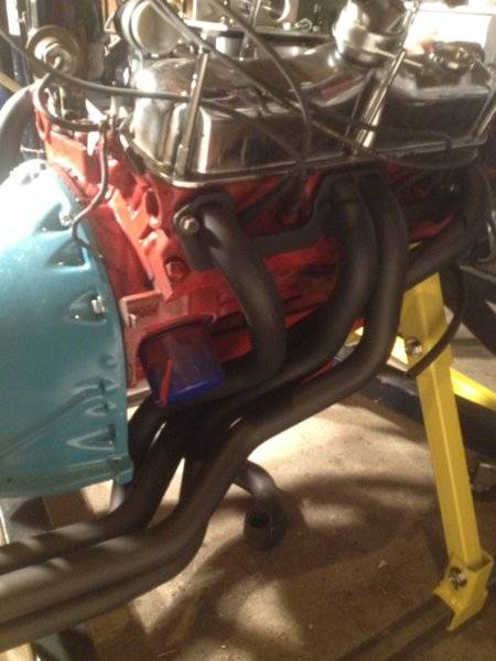

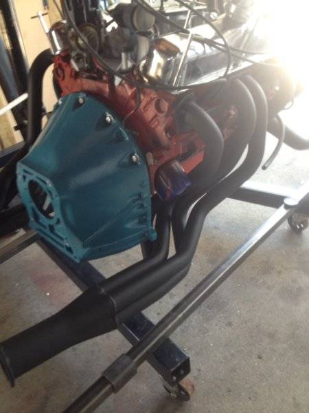

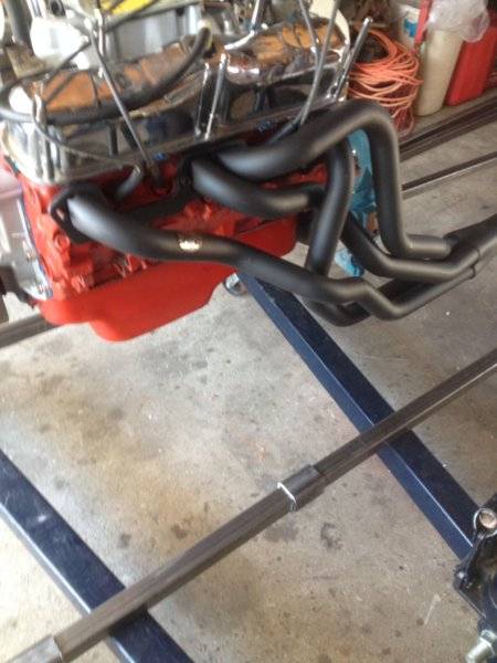

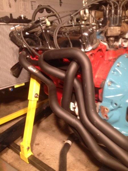

As far as headers go, if you want to go there and use them, IMO, there is only 3 headers worth looking at. The cheap 1 size fits all are a pain and not really where you want to be in the end. There is headers by Doug. TTI & what I used, the Hooker Super Comp headers & 1-3/4 tube size. They fit awesomely with excellent ground clearance. Use a 2-1/2 inch exhaust tube w/a H or X pipe. All of the above choices on headers are expensive and so super worth it in the long run. Been there and done that I have and for certain, I will it be going back to those cheap headers EVER again!

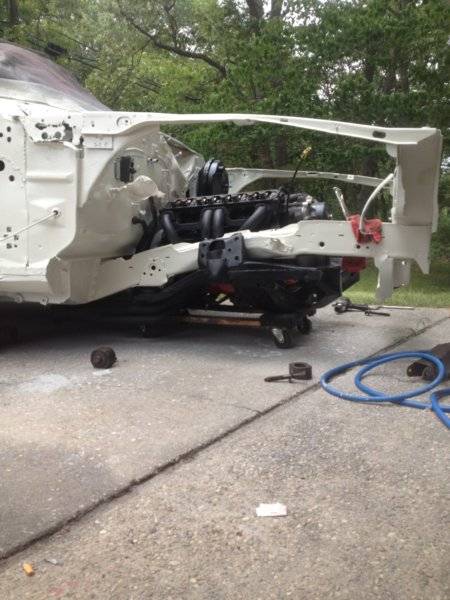

This is the one I used for for my carbureted 5.9 magnum engine, “CARBURETED” being the key word here.
