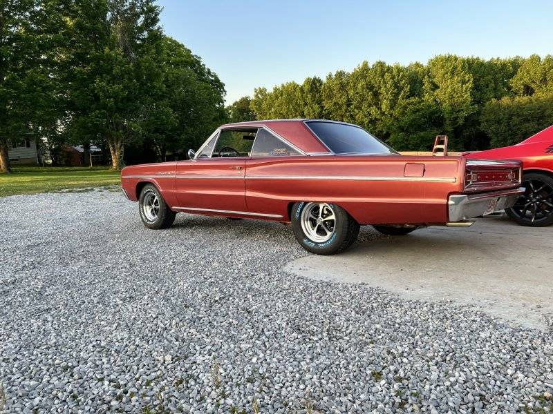

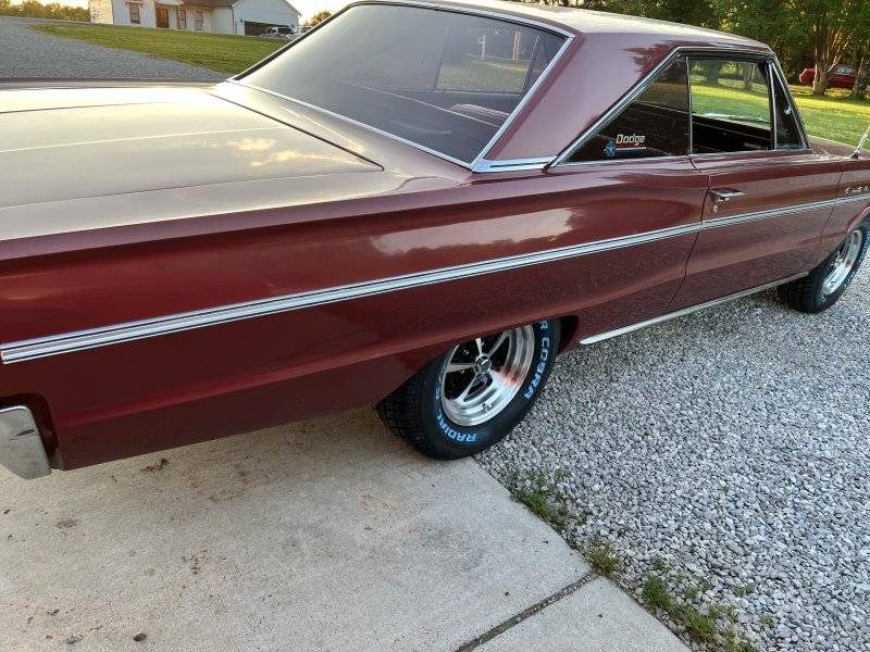

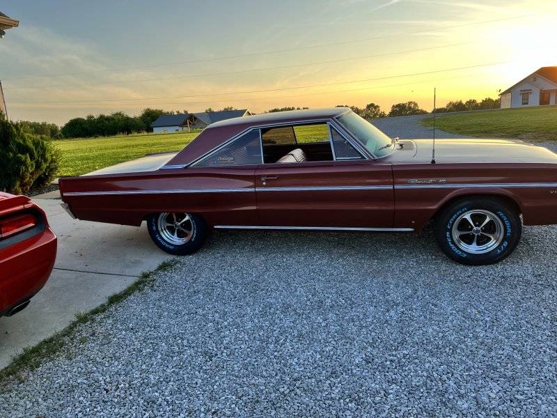

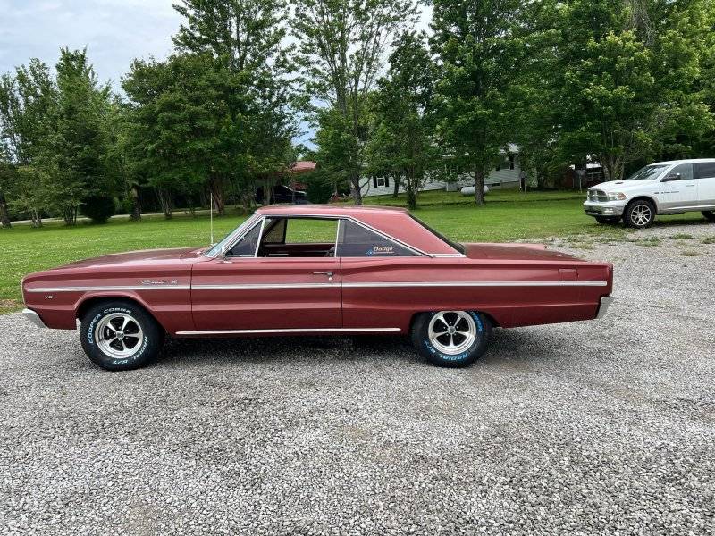

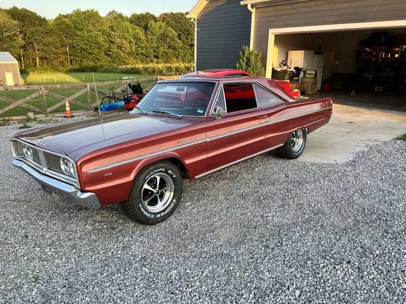

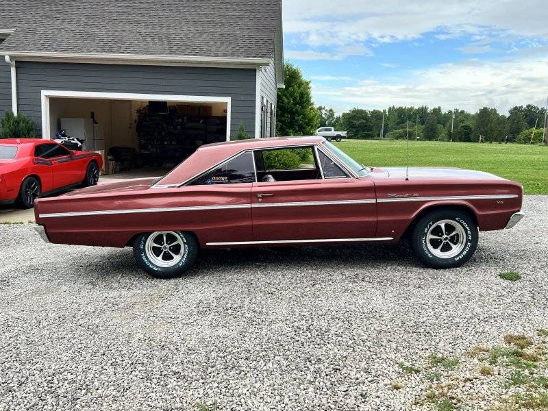

Looks great ,I went with American Racing aluminum Magnum 500s on rear I went with 15x8 4.5 BS with Cooper Cobra 275/60R15 had minor rubbing on outside wheel lip so I had to have them turned down 3/8”. Went with 15x7 4.25 BS WITH 235/70R15 on front.The fit is great, and the look is awesome !!!View attachment 1677888

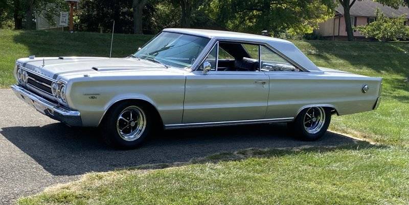

I ordered from Summit, a couple of yrs ago. 15 x 7 front & 15 x 8 rear w/ 4.5” BS and the bullet caps were separateCincy Kid. Whose chrome wheels did you use with the bullet caps?
