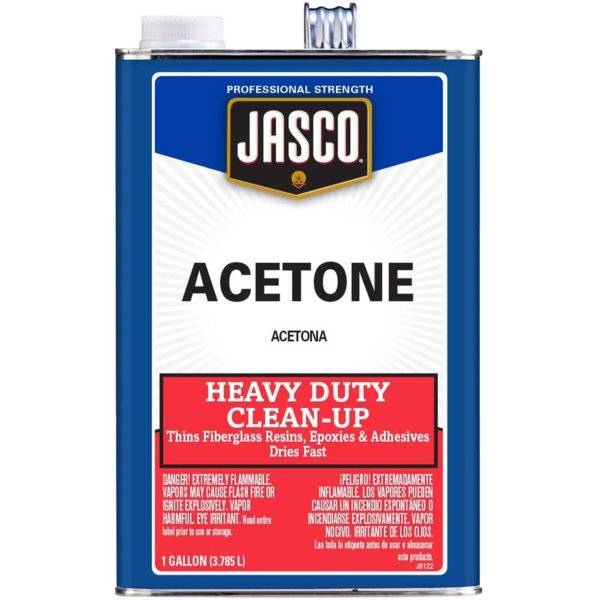

Do you use the acetone in the pickup as well?Don't happen all the time, one will go 10000 miles the next will go 200,frustrating.
YepDo you use the acetone in the pickup as well?
I think I'm gonna put the fass fuel filter system on it tired of screwing with it.Do you use the acetone in the pickup as well?
Is that the remote, twin filter system?I think I'm gonna put the fass fuel filter system on it tired of screwing with it.
Yes it isIs that the remote, twin filter system?
How do you measure the acetone for the KW? Do you treat both tanks?Yes it is
1 oz acetone per 10 gallons of fuel at fill upHow do you measure the acetone for the KW? Do you treat both tanks?
All in the drivers tank or do you treat both tanks?1 oz acetone per 10 gallons of fuel at fill up
Don't matter cummins returns so much fuel it will be mixed in 30 minutes.All in the drivers tank or do you treat both tanks?
I guess the wife is going to be missing one of her measuring cups.Don't matter cummins returns so much fuel it will be mixed in 30 minutes.
