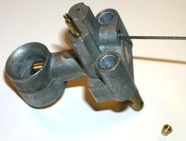

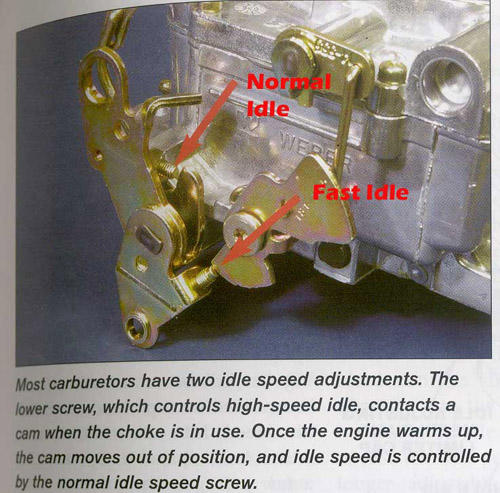

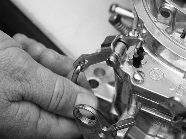

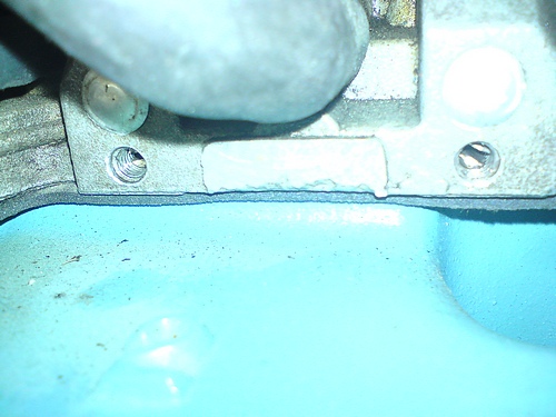

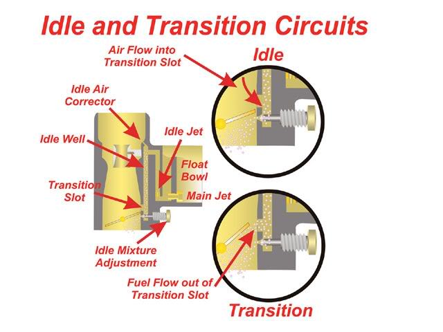

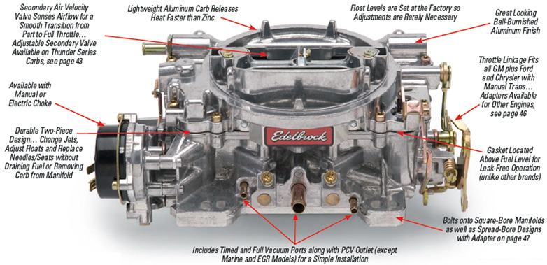

I would highly suggest you buy a Book on "how to tune Edelbrock/Carter Carburetors for performance/racing", maybe go to www.edelbrock.com they use to have a calculator for their carbs, to give you a base line only, I believe they also have a book/cd you could purchase also... If your going to be racing you will need an assortment of rods/jets etc. the Relative air density/altitude changes Weather station would be a good idea too, along with weather changes, sun or clouds etc. to make the proper jet/metering rod changes... You will need to know all the variables, to do the tuning correctly, there isn't just one specific # you will use & every engine will be different depending on many different factors even if they are built identically... you could try Mancini Racing web site also they sell many tuning books {like in the last 2 photos} & many appropriate tuning parts also
