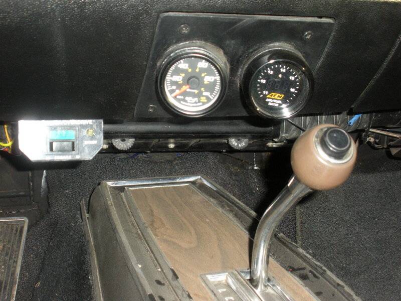

My car is tuned using a wideband Air-Fuel meter that I have in the car mounted to the dash.
This was taken a few years ago...
I had a Gear Vendors overdrive and an automatic trans then!
The gauge you want is the one on the right...AEM is the manufacturer.
