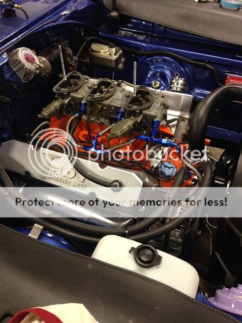

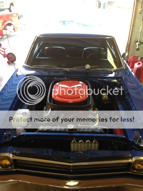

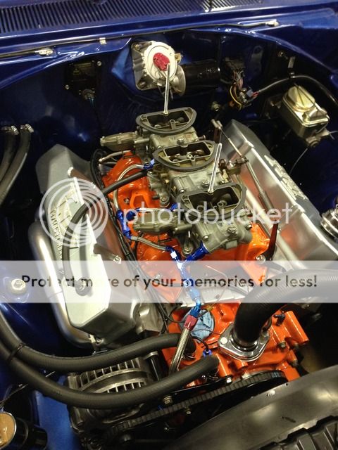

fired up the 511 yesterday and ran the cam in. just gotta put the inner springs back in and go for a ride. She sounds good and healthy. I'll try to find time to update my roadrunner 8.4 thread with some pics soon. Hopefully get some dragstip data too this summer once work slows down.
In case you missed it
This
To this
This
To this
lets see and hear it run........ looks good man
Nothing looks better then a 6 pack that's for sure. Sure miss the sound when their all open. Looks fantastic to me
Wow that looks great ! You should be proud to show that bad boy off. I also run the PCV setup on my 493 street eng as you can see. Ron

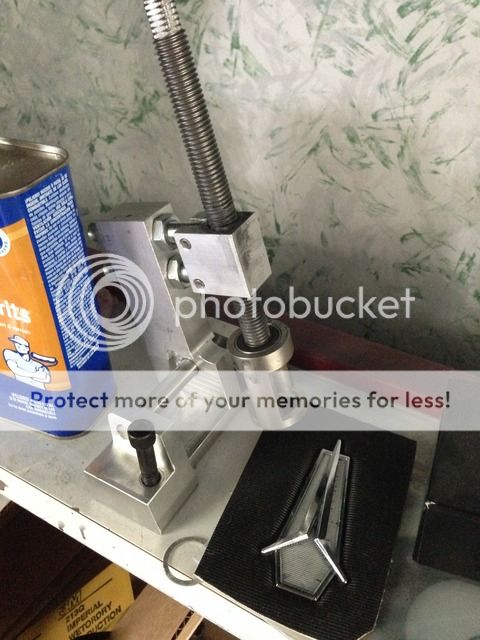

I also broke my cam in on just the outer springs. Then I used this tool to put the inner springs back in and boy this tool works great. Ron

Ron this engine is similar to yours, has basically same cam except down 1 size. I think the road runner prob needs a little more torque, she's a fat bird.. I did chose to go a big standard port window so I could keep the 6 barrel though
I have one a buddy made for me. Works great!
Thats a very nice tool and looks like it works basically the same as mine. What I like about mine is you can run the allen head screw down to push the spring down and then use both hands to remove the keepers as you dont have to hold a tool with one hand. I think your Runner is going to run strong with your combo. Good luck with it. Ron
