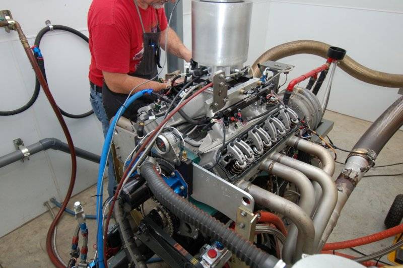

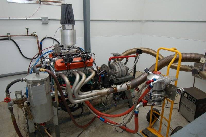

Ran my 514 on the dyno last week. Had a bunch of problems with the injectors and the fuel but finally got it all sorted out and the engine responded with 880 hp. Here are a couple of pictures.

Do you have a link to an article for more detail? I’d love to learn more about that coil near plug system you’re running.
Cool stuff. I like the rocker arms, is that the T&D or Jesel setup?
Sounds really expensive! Pretty remarkable, just watched a 598 Chevy with Brodix heads on engine masters make less than Andy’s 514 wedge here. Absolute insane power naturally aspirated.
I'm working on a coil near plug article for Hot Rod but it isn't finished yet. Here is an article I did about a year ago when we first ran this engine with EFI. The coil near plug is new, but the rest is pretty much the same: https://www.hotrod.com/articles/holley-hp-efi-install/
Indy EZ heads with Jesel rocker arms. I have 1.85 and 1.70 rocker arms for the engine but for this test I was using the 1.70 rockers. Valve lift is around 0.800 inch with the 1.70 rockers.
