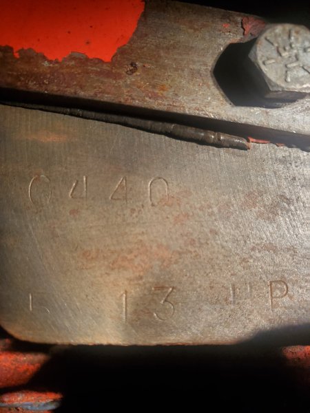

Here's a picture of the stamping numbers on the HP 440 6 pack engine...
440 6 pack engine stamping. G440 5 13 HP

Oh ok thanks. The one in post 27 looked like C . But if it's a G, it's a 71 block.
