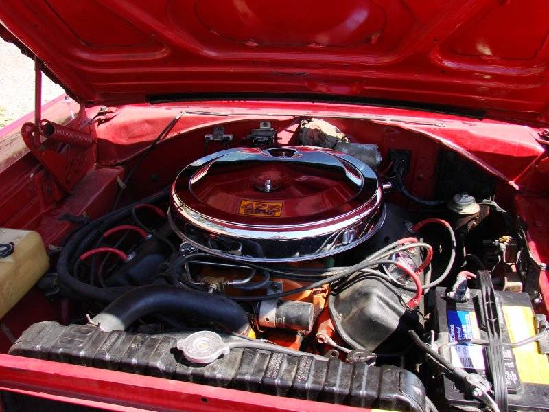

Cool swap. If it was easy anyone could do it, that's why "anyone" owns Chevies. I don't think those are wider than a 426 and I had PS in mine from the factory.

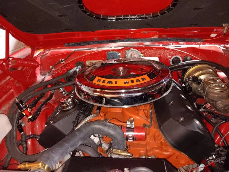

Now a early Hemi in a early A is a shoehorn fit but it looks right at home in there.
that looks perfect what steering did you use please and did u fabricate the engine mounts ?
1967 Dodge Coronet with spool mounts and factory air conditioning car with power brakes. Re located factory blower motor deeper into air box and used customer belt/mount for air conditioning compressor
