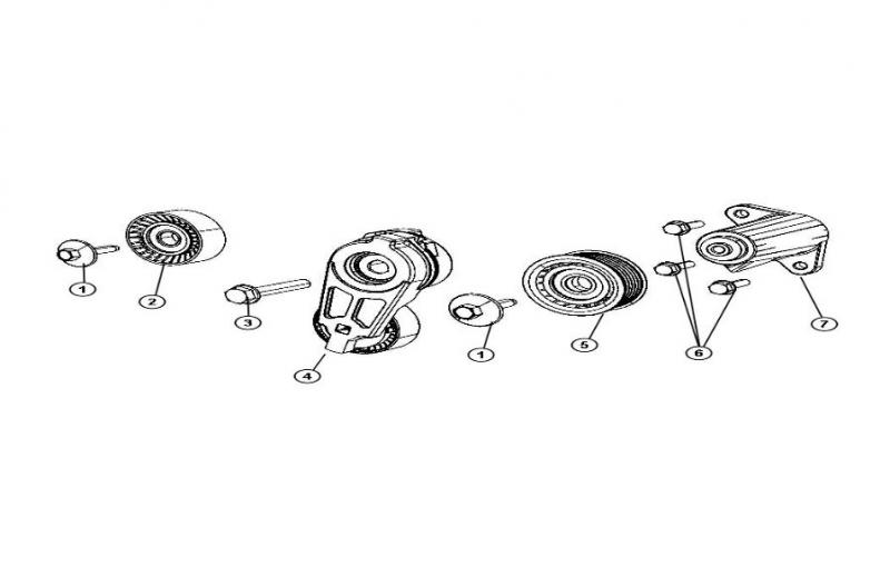

04627851AA is the grooved idler that is required for the PS delete. This will mount to 04593918AA.
BRACKET. Idler Pulley. 04593918AA $46.85
TENSIONER. Belt. 04861660AA $51.17
PULLEY. Idler. 04891720AA $18.63
PULLEY. Idler. 04627851AA $16.47
1 - BOLT. Mounting. Hex Flange Head. M10X1.50X55.00. 06104221AA $3.51
3 - BOLT. Mounting. Hex Flange Head. M10X1.50X130.00. 06104230AA $2.70
2 - SCREW. Hex Flange Head. M8x1.25x34. 06509487AA $2.50
3 - BOLT, SCREW. Mounting, Tension Bracket Assembly To Timing Cover Front, Tensioner To Bracket. Hex Flange Head, Hex Head. M8x1.25x30, M8X1.25X30.0, M8X1.25X30.00. 06104025AA $4.59

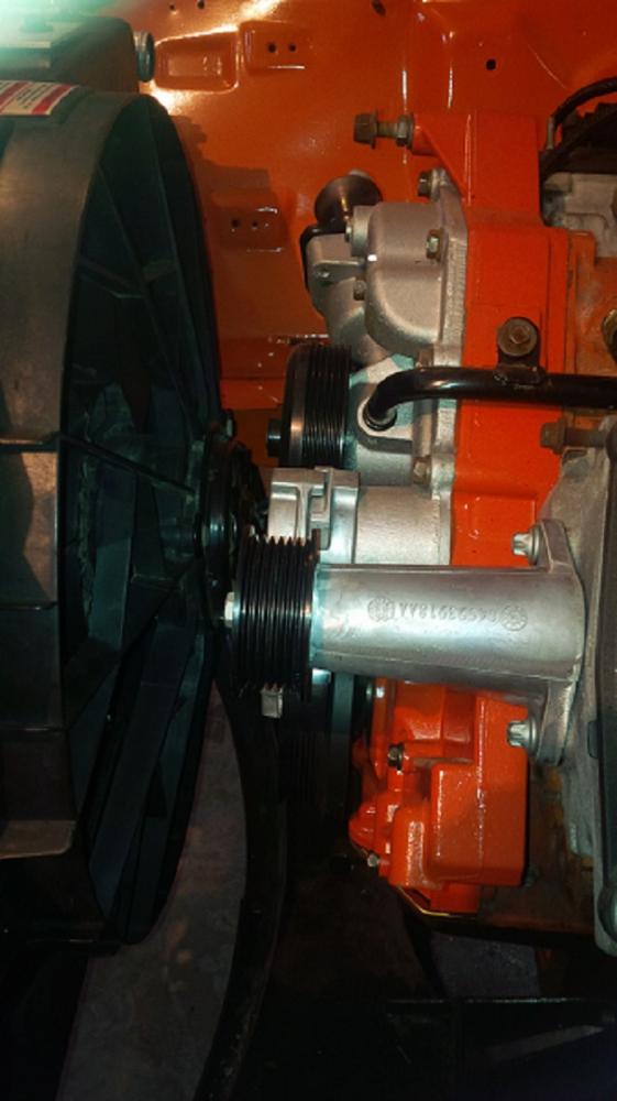

So I ordered and in stalled on my 2006 6.1 grand Cherokee block. SHOOT too long . any ideas ? I am talking with FABO as well seems to be a big topic

ya I looked at them . but seems to be an because of the fact im using the grand Cherokee block . the factory delete is being used on the 5.7 . this one you sent may have the same problem .
The blocks are identical no matter what application. The only differences are timing covers and pulley/accessory arrangements. I believe the grand cherokee engine is setup like the cars.
The idler pulleys just bolt to a stud essentially. Why not make your own? Make a plate to match that base plate, weld a piece of tube with a couple gussets to the plate and weld a plate at the end tapped for the bolt. Then use a washer or two to space the pulley out and give it clearance and bolt it down. I did something similar on my truck motor except the stud I used was already there...just added 3-4 washers and bolted it down where I needed it.
ya seems like a lot of work for what its worth . my thoughts have been is there an offset pulley?
