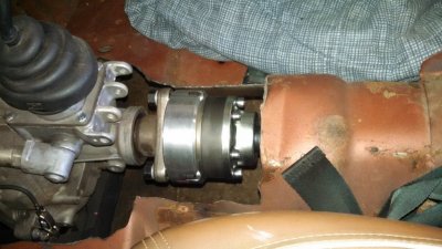

ive done that swap, tr6060 is a pain but can be done. when i did it a year ago headers were not available as the starter is on the passenger side with the tr6060, i had to make headers for it, there may be headers now i dont know. the whole trans tunnel section has to be remade taller. torsion crossmember has to be cut severely and then a new arch made. there is no speed sensor on the tr6060 so i mounted an abs reluctor wheel and sensor to the 3rd member yoke. tr6060 has no bleeder for clutch. i had to t-off the hydraulic line and make a riser line that was above the reservoir, worked perfectly didnt even have to pump the pedal to bleed it. you will have to get an adapter for the driveline and run the collapseable type of driveshaft. efi fuel system. change the oil pan to fit crossmember and steering.

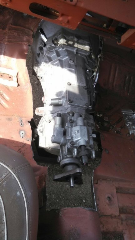

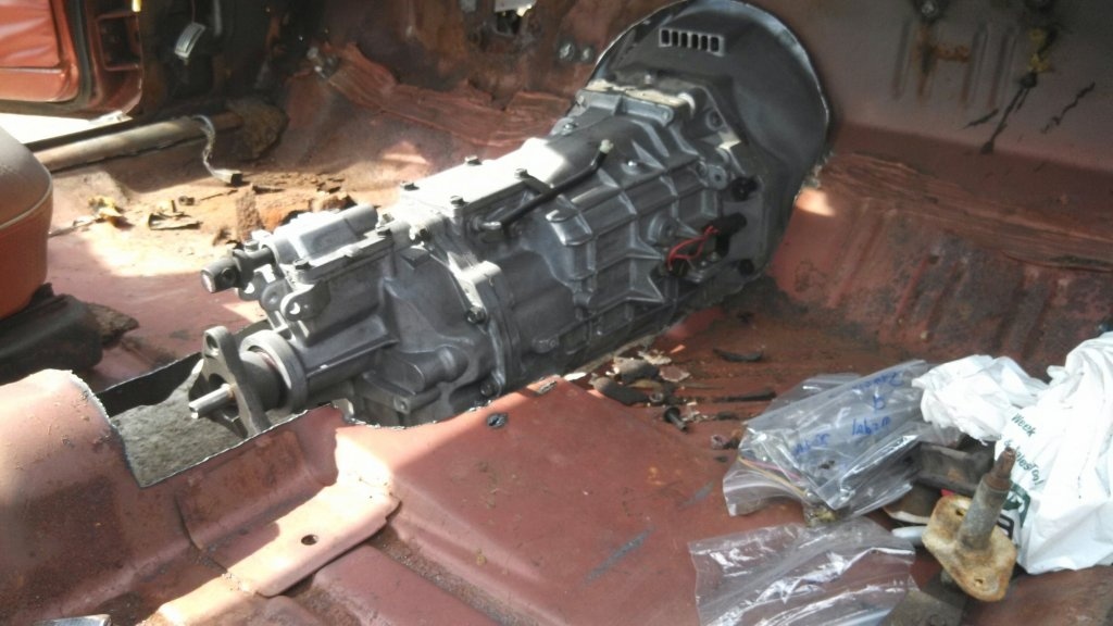

To fit the tr6060 exactly as it came out of my donor car in my 69 charger the only option I found that made sense was cutting the floor hump up to the firewall out of the rolled challenger and using it as a guide to to cut the stock floor hump. It is significant as the entire center section of the car is going to be cut out. Your console or buddy seat is a goner and you have to fabricate new bracing and supports. The console out of the challenger fits quite nicely with some tweaks and you can connect the ac vents in the console to your dash hoses. I'm no Gen 3 hemi expert but fabrication is fairly simple for me. I didn't mind all the cutting but if you have a numbers matching car or a hemi car.... keep your 833 or get a passon

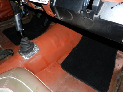

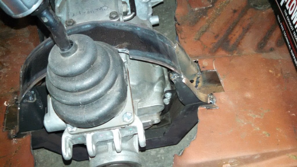

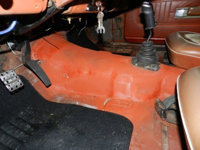

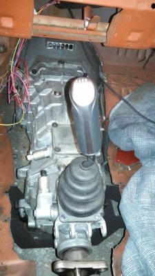

i put the tr6060 in mine behind the 6.1, my body guy scalped the hump, an added about 2.5 inches and reweld back in place. hardest thing was putting in the arch over the trans. we pieced a 1/4 inch piece of metal and fit it in with the factory trans support.
ResizedImage_1397354237931.jpg ResizedImage_1397354184055.jpg IMG_20140603_201202_123.jpg DSCN1406.JPG DSCN1407.JPG IMG_20140726_172459_723.jpg IMG_20140814_154949_290.jpg

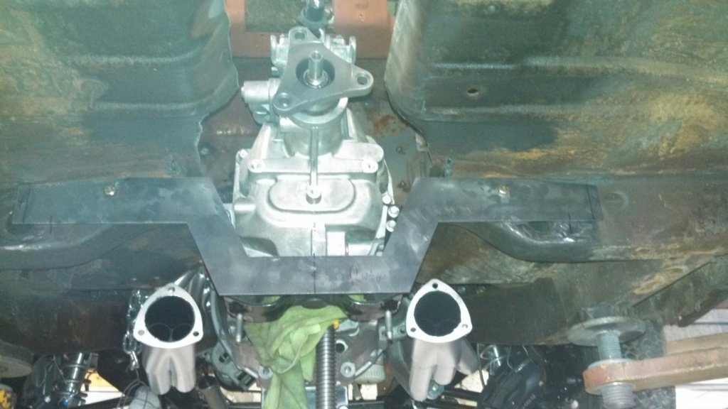

heres what i got, i think i got more. if you go to members projects and go find the thread "my 70 barn find" it has the build so far. it goes in oct for the dismantle and we are redoing the cross member, this is a photo type. new one will more rounder an smoother. thanks and good luck on your build.

Check out my posts starting on pages 93, 94, 95 . . . it shows my process for fabricating the cross member - we had to go through about 5 iterations of how to do it until we got something that we liked - and worked . . .
got lots of pictures and text describing my thoughts and my process . . .
