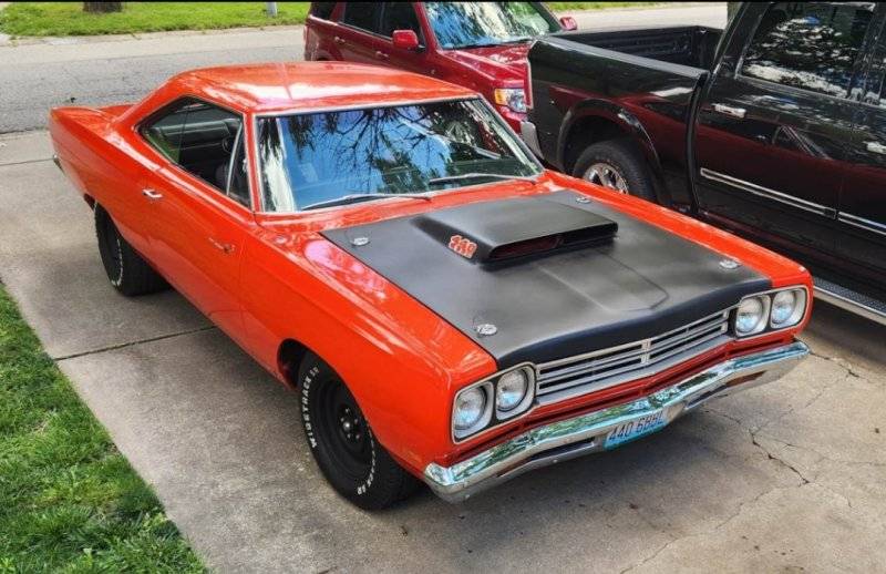

I recently acquired a 69 Road Runner 440 six pac car. Not an A12.:( I don't know much about the engine, how it was built, it's cam, etc. I would like to take the car to a six pac guru, a master at tuning these engines. Someone that will guide me to get the most from my combination. This is a street car. Suggestions ????
I am in North Carolina but will travel wherever for the right guy.
THX !!!

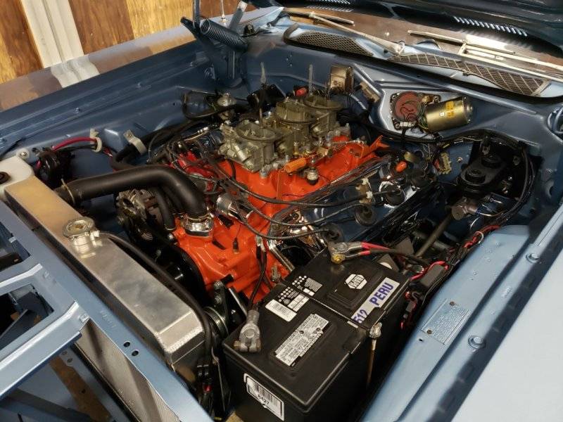

The six pack is just plain miserable if it's not right, and getting it right is also a miserable task. You want to re-jet the centre carb?? Be prepared to pull the rear carb and break the fuel line connections in a strategic way to not box yourself into a corner. I too have a six pack that I'm bound and determined to make work and have it live on my 69 RR (not A12 car) so as time goes on, I'll be cussing at it until it's right.
So far in my own experience I found the EGT for #3 cyl and I believe #6 to be high and the result burned the paint off those header primaries during cam break in. This indicates those cylinders are very rich so clearly I'm having fuel distribution problems. The idle mixture settings on the out-board carbs are also critical.
Recently I have been in contact with Bob Karakashian (Mr. Six Pack) and he gave me the following BASIC settings to start out with:
Use either #65 or #66 jets on the centre carb. Use #82 jets on the pass. side front and rear carb. Use #84 jets on the driver side front and rear carb. These are starting points. Use a 3.5 or 4.5 power valve and if the car wants to idle with the centre carb butterfly’s past the idle transfer slots, you probably will have to drill a small hole, .090-.110, in each butterfly in the centre carb. This assumes billet jet plates in the outboard carbs.
My cars don't idle past the transfer slots so no issue there, but I'll add if you have that problem you need to first check and/or correct your initial timing. Timing in the tail pipe will cause you to crank open the idle speed screw.
The opening rate of the out-board carbs is also controlled by a bleed off orifice in the out-board carbs. The internal passage is teed with one port going to the vac diaphragm and the other to the main venturi. I have seen two sizes of this bleed orifice - .067"-ish and I believe .043". The smaller bleed orifice will allow a stronger signal to the vacuum diaphragm and vice versa. On one of my sets of factory carbs the bleed orifice is .067" on one carb and .043" on the other. WTF??? I drilled my currently running outboard carbs to the larger size and put the black spring. This made a huge difference and believe is a step in the right direction. Also I will note that the opening rate is not linear. I watched them open under load on a dyno and what I found was the initial opening was very quick to about half throttle then very slow after that to not fully open depending on what springs are installed. I think I would prefer the opposite.
FYI: The Ford Tri Power carbs had a progressive linkage and were mechanical. You drive on the centre as you'd expect then as you lean on the throttle the front tips in first and finally about 1/3rd to 1/2 throttle of the front carb opening the rear comes in. I thought for a minute with my old factory set with different size orifices front and rear that the opening would function like the Ford but then decided that's impossible because the safety linkage ties them together.

I followed the old DC manual recommendations back in the 80’s. The jetting of the center carb, the drilling of the metering plates of the outboards, popping the lead plugs on the outboards, and richening the idle mixture, yellow springs.It’s been a while but they worked great.
I never have any issues with my six pack cars. Yes, it does take some work and effort initially. Every car requires a different tune. Yes, you can go by some tech tips from others. Just have to keep tweaking it for what your car likes or wants.
My six pack Charger has been flawless since I rebuilt the engine and tuned the carbs back in 2007. Still going pretty much untouched with almost 60,000 on it now.
Start by disconnecting the inboard and outboard carbs. Tune or adjust the center carb. It's easy and you'll learn alot. What are you going to do when/if there's a problem? Take it back to California?
Then adjust and dial in the front carb. Switch it to the back and then adjust the rear carb you moved to the front now that it is up front.
I sure would not be able to tune my front carb and then switch it out with the rear carb. Drastically different on my small block stroker. Maybe the big block is different.
Two major keys to 6paks. First check manifold fitment. Edelbrock has never figured out to properly machine the intakes. Second is to circumvent the smog idle circuits with the center carb the major culprit. Aftermarket carbs aren't as good as originals. All the secondary aftermarket jet plates and gadgets are just unnecessary junk. Don't try to re-engineer them. They are not a race setup and don't treat them as such. I've ran every carb combo out there thru decades of screwing with them. The mechanicals are no brainers to tune, but I've always preferred vacuums for street use; even though they can be miserable to tune.
