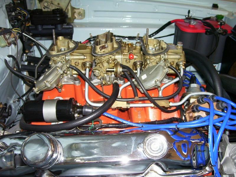

Looking for a little more than the stock lines . Does anyone make a ' custom ' set-up or is it something that I'd have to get all the seperate pieces and cobble it together myself ? Open to other thoughts and suggestions...:icon_confused:
Those carbs are pretty cramped so you might have a fight on your hands trying to squeeze something else in there. I have seen someone use the AN fittings and braided hose but the hoses will not be a straight shot from the bowl to the distribution block or fuel log. I'd just leave the stock 5/16" line.
this is a 3/8" line i put together. that was complicated enough for me. i think Promax makes up a -6 line set-up.

lewtot,
nice job! probably took a while to get it looking right.
lewtot,
thanks. doing a 3/8" line isn't as straight forward as 5/16" due to bend radius differences and limited space. i've done fuel logs also but don't have any pictures. i don't like the braided lines due to expense and they have a somewhat disorganized look to me.
I did 3/8" line with AN fittings coming out of a 3 port distribution block. It is nowhere near as clean as lewtot's.
