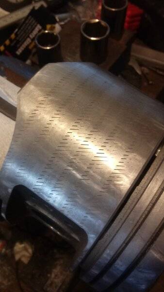

Hello everyone, Anyone know why these pistons have this texture on the sides and what they were for? They are on new 440 source forged rods and I was told they'd be fine to put in my engine but I've never seen pistons with this. I've always thought they were suppose to be smooth, all 8 have this. Thanks for any insight
Those have been knurled by a machine shop. It is to tighten them up in the bores. Like knurling valve guides. A temporary fix.
Measure them and your bores then you will know your clearance. if its good use them.
As Mike said knurling is very much a temporary fix... If you are building a show poodle go ahead & use them... If you plan to put any serious miles on the car I would rather do it right & only have to do it once.... Knurling was a patch type repair from the 40's & 50's when people only expected an engine to last 20-30K miles..
Thank you I didn't think I should use them. I'm building a mild street 440 that I'd like to enjoy on the road but it's got the .130 in the hole pistons which made me curious about these. The extra point on compression isn't worth the risk. From these at least. Thank you again for the insight and advice!
Those are knurled, which can work for while, not he best plan, but... If you are .130 down the hole, that's a really mild deal. I'd find some pistons to get you up .020 or .030.
Edit: If they are 6Pak pistons they should not be down .130. with a stock 6.76 rod. They seem like late '70's pistons.
These are 6 pack pistons, they've got the same specs as the l2355's and the valve reliefs. Reading up on knurling I'd assume they're also older pistons that someone put on some new rods too. I was curious/directed to them because the pistons in my 440 are the low com .130 in the hole motorhome ones.
OK, That knurled 6pak piston will not be .130 down the hole. A knurled piston will perform fine for a while. How long don't know. That was a common deal well into the '70's. Mopars don't wear the pistons very badly because of their L/R ratio. So a knurled piston could last a long time. Just say'in.
Have the pistons mic-ed. You should be able to get a measurement on both the upset (knurl) and not upset part of the skirt. My guess is they are probably fine if your starting with a different motor. The pistons were knurled because of the cylinder bore. If there is some knurl left, its probably not much. Have the new block final finish bore to 0.0025" to the knurl and when the rest of the knurl wears, you'll probably still be in tolerance. That piston will be fine to 0.005" but will have a little slap.
Or maybe just dress the skirts

A fellow I know offered to sell them to me for my engine. My engine is a std bore with perfect cylinder bores no rig rim no nothing. it was a less then 5g miles motorhome engine. Those are std pistons so they would/should go in without any problems. Just balancing the Crank to them. I was cautious about them due to the texture on them which I now know is from knurling (Thank you again everyone for all the info). I've decided to pass on them and just stick with what it's got and do a freshen up on the engine.
