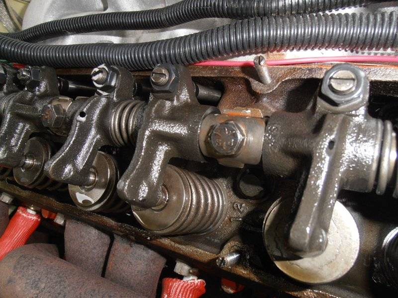

like mine @Cranky ????lol
Ran a set of those on a 440 that saw 7300 on every pass going across the stripe and actually stayed adjusted!! Cam was a 660 lift Isky roller. A buddy of mine had them on a 600 solid non roller cam and the the Isky rockers didn't like that lol. Had to adjust them quite often. Don't remember the brand of cam or lifters though

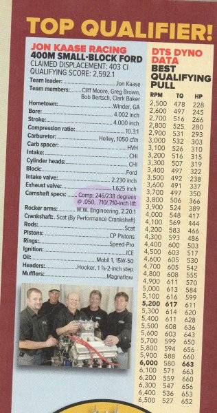

Another one who gets it. Multiple EMC winner & winner with the 400 Ford engine below. 4" stroke, very short 5.565" rods for a 1.39 r/s ratio. Made 660 hp with a mild cam.
