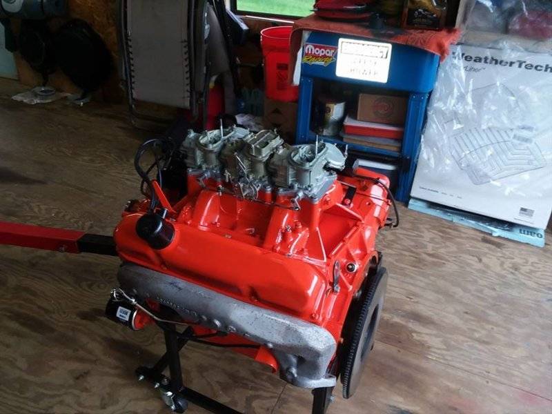

has any other 6 pak guys use Phil Fish he has just completed my carbs. looking forward to getting them back on my car. he assured me they will work better than the 4bbl. im using now.
Phil did a six pack setup for my Brother in laws 70 Challenger is starts idles and runs great. He also did a set of crossram carbs for me that start and idle fine just working on the final tuneup.
has any other 6 pak guys use Phil Fish he has just completed my carbs. looking forward to getting them back on my car. he assured me they will work better than the 4bbl. im using now.View attachment 629559
