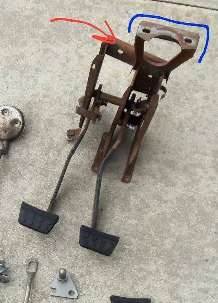

Mine came with the upper section that turns up, red arrow.

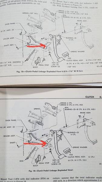

I've seen them where this piece turns down, and I checked both the 62 and 64 FSMs and this piece turns down in the pics, and shows no additional bracket.
Either way, you can't flip it.

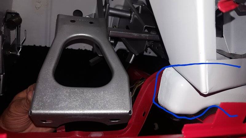

Mine also came with the extra bracket, outlined in blue.
Some have it, some don't.
Since you can't flip the upper section, it determines how the extra bracket mounts, flipped up or down.
If I add the extra bracket on mine, it has to point down, no problem, and it has to be between the upper section on the sides.
If the upper section turns down you can just bolt the extra bracket on top, but it has to be flipped.
So, my extra bracket ends up flush with the back of the steering column bracket, shown in white outlined in blue.
It literally becomes the back of that column bracket, right up against it, but no way to bolt them together.
I just measured my 64 which is 15" from the firewall to the column mount, and my 62 which is 17.5. That didn't help as the extra bracket is longer than 2.5".
What's the deal here, am I missing parts?
Why the different upper bracket?
What years need the extra bracket, and how is it attached in the back?
