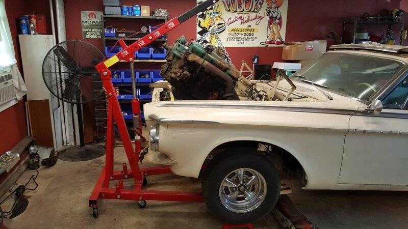

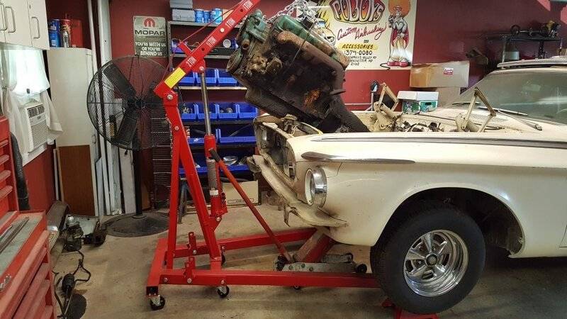

This is pulling a 361 with the automatic attached. I could have dropped the front back on the floor but you can see you run out of room on the boom. It didn't go back in this way. Installed the replacement 440 and then the automatic last. The 440 is a bit heavier so I didn't want to chance it doing this by myself. I might have dropped the front back down after the last pic.
