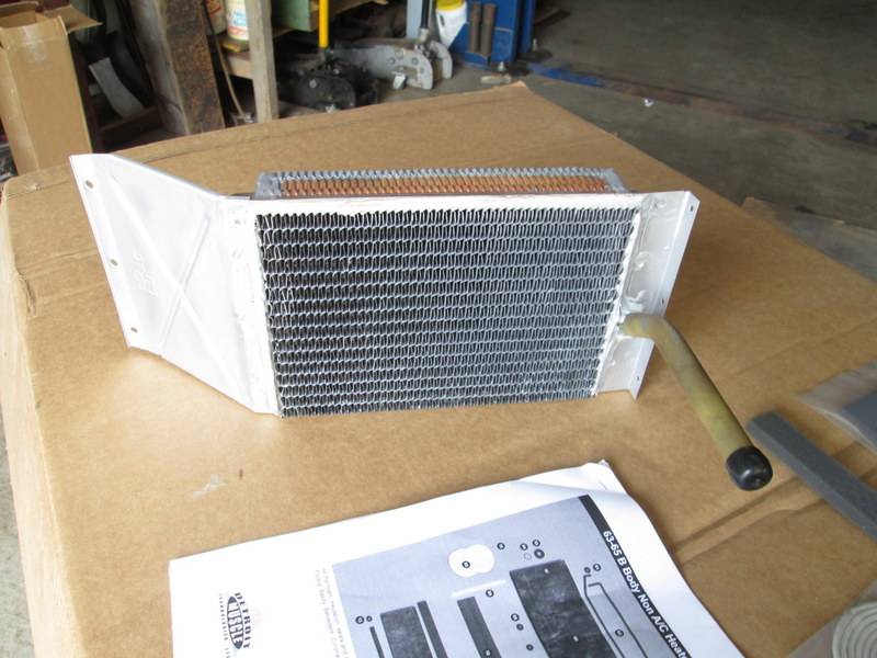

couple weeks ago I posted Jegs has replacement heater cores for the non A/C B body cars, it looke correct, when I tried to install it, the difference is night and day- with some adapting it is in there but it is not what they advertise it to be.or is that to B?

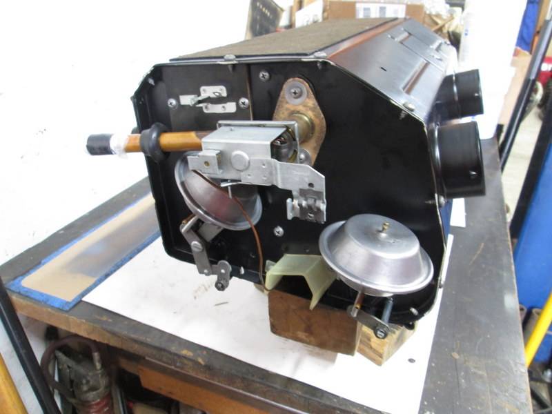

Here's some pics of my '63 I did this year. I used my original, and had Bob at Glen Ray go over it before the reassembly. It's not back in the car yet, but ready to go...
Here's some pics of my '63 I did this year. I used my original, and had Bob at Glen Ray go over it before the reassembly. It's not back in the car yet, but ready to go...View attachment 679384 View attachment 679385 View attachment 679386

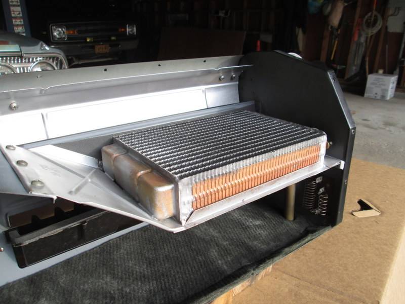

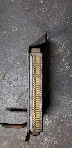

here is a shot of the original shape of the attachment extensions, yo ucan see the difference in shape, on the outlet end the screw holes did not come close to alignment- but not an issue to redrill and and secure, the new heater core is also about 2" shorter than original which makes the difference in the angled end, but that also had to be redrilled to fit, its all good, fun project, now to find someone who can lie on the floorboards and install it all. not

The new ones are made in Mexico from what I have seen. 68-70 models inlet/outlet are about 3/4" too short.
