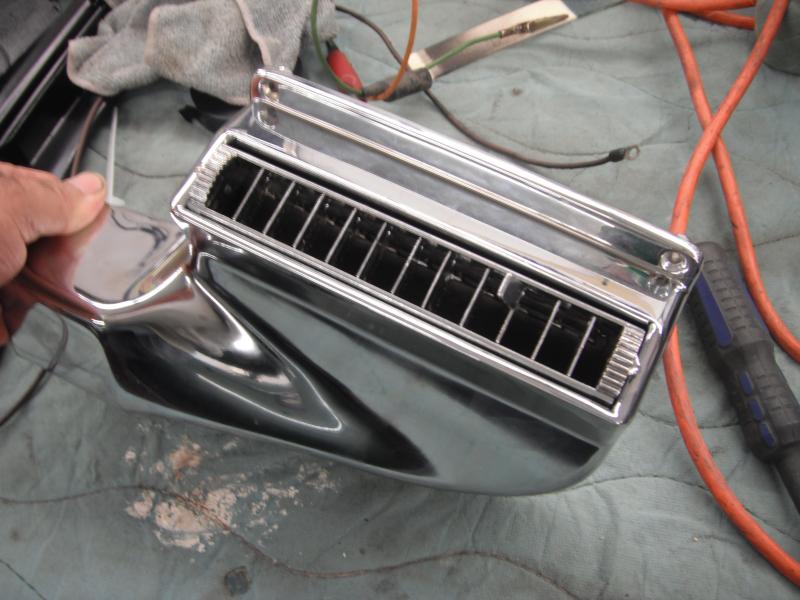

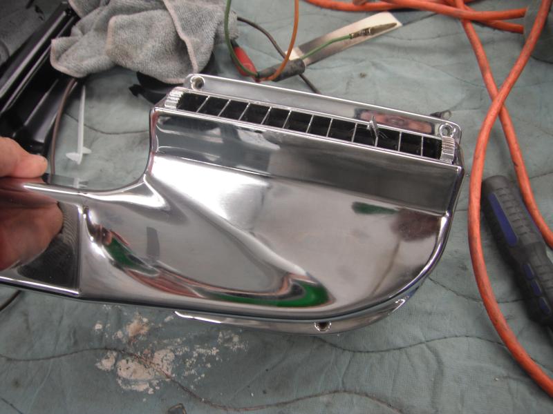

Need some help anyone out there have some pictures of a 62 Dart with factory A/C? Need some pictures of the dash. Can't figure out where the lower r/h a/c vents mounts. Thanks

Got the answer from Joe Suchy The A/C vent assembly is for the right side of the dash. The 2" square in your hand points straight up. The vent mounts on the kick panel. There are 3 screw that hold the panel to the body and there should be 3 more holes that are approximately 3/8" that the stand-offs on the back of the vent go through.
I have air but like yours it isn't installed.....thanks for the info ,you've helped me too :hello2:
Wow that chrome on the pott metal looks awesome.....what condition was it in? Mine has slight peppering.

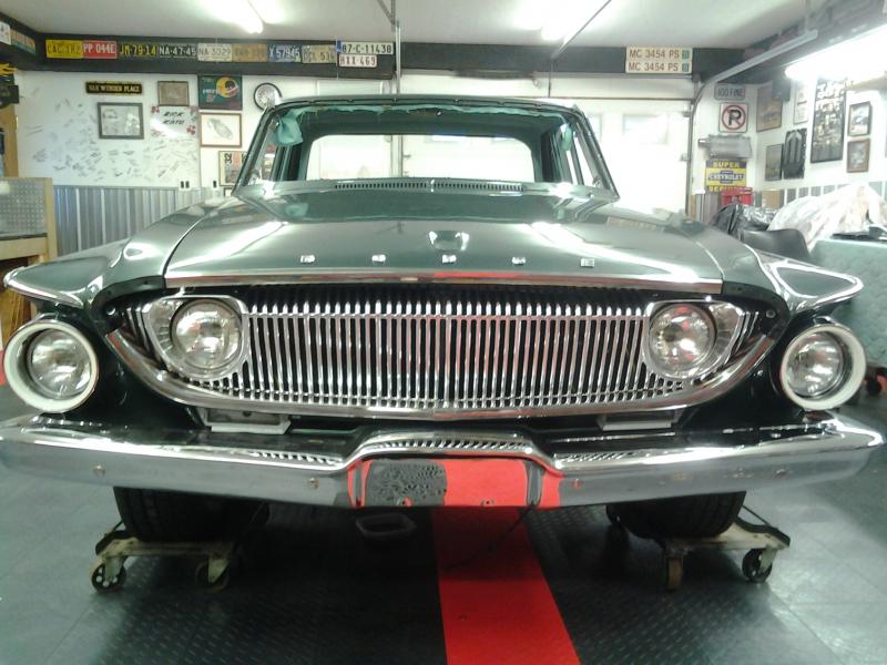

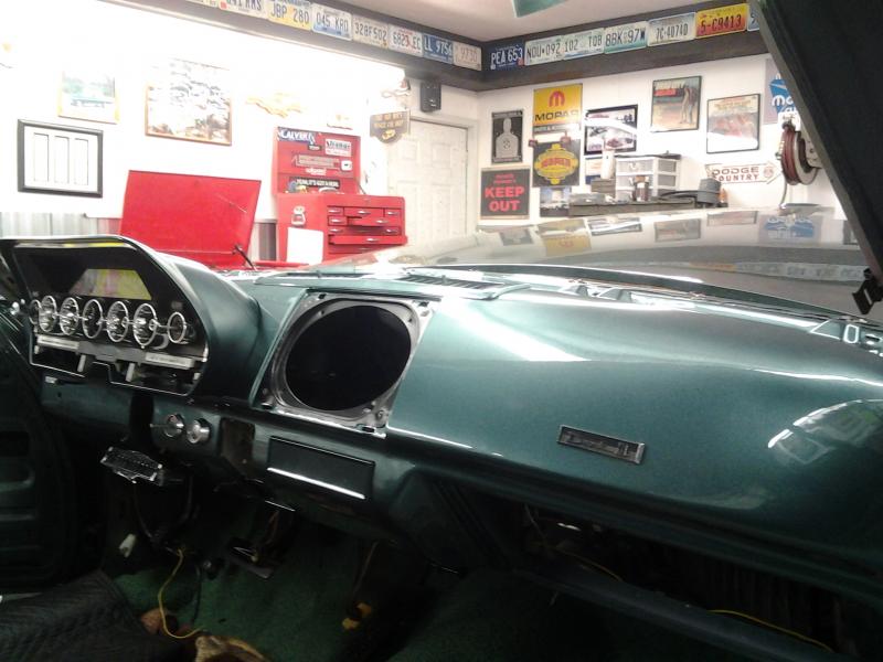

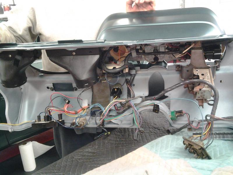

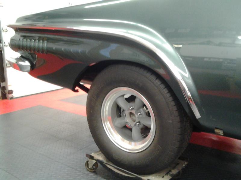

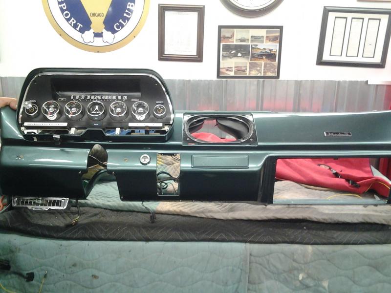

More progress on the Dart. Got the quarter panel trim on on, Driver side head light bezel on, dash assembly wired and tested ready for installation.
Keep those pics coming ,your getting closer & closer to the finish...must be exciting?

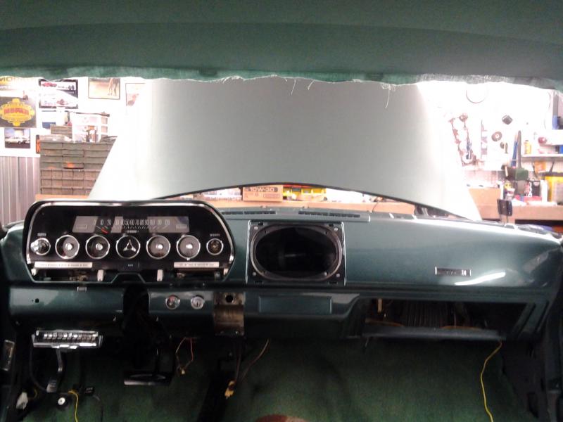

Been on vacation for the last couple of weeks. Going to get back after it this coming week. Waiting on my A/C clutch from vintage air and installing the dash assembly this coming week then it will be ready to start.

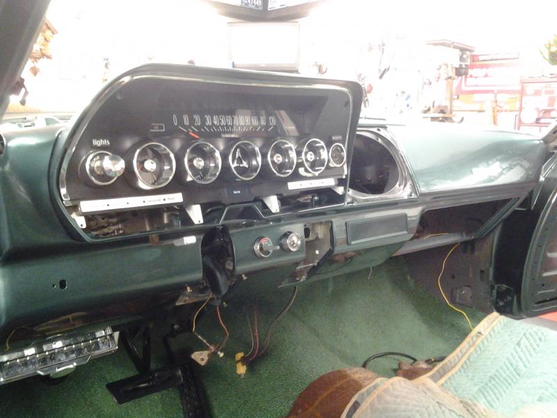

Dash is in now hooking up all the wiring
Good day yesterday got the Dart fired up for the first time. Sounds real nice and actually eleminated a couple of mice nests from the exhaust. Now today is clean up day and play with the tune up. I was pretty amaized that she fired right up and I had no electrical issues/fuel issues and only one minor water hose leak. All the dash gauges are working and with the cam brake in procedure of 2000 rpm for 20 minutes she never got above 165 degrees F. Maybe will be able to take it for a test run in a couple of weeks just need to install the window glass and finish up the interior. Merry Christmas to all
