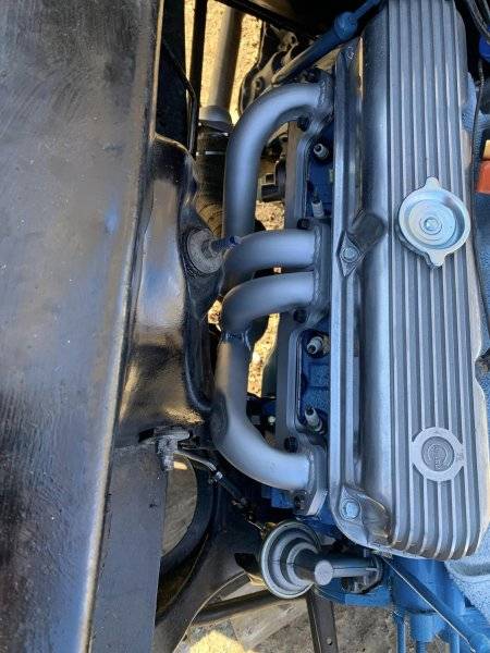

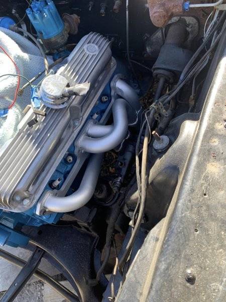

Isn't the 273 an LA motor? I pulled the 273 from my 65 Belvedere wagon and installed a late 70s LA 360. I bought the shorty Shummacher headers. They were a little pricey but I also added the ceramic coating. They just dropped right in with only one pipe that needed to be dinged on the passenger side. Sometimes you are better off spending a little more money to save a lot of aggravation later on.

The only other thing about the shorty headers is that I had to install an oil filter relocation kit. (Top center of pic) The stock filter would be sitting on the header.
