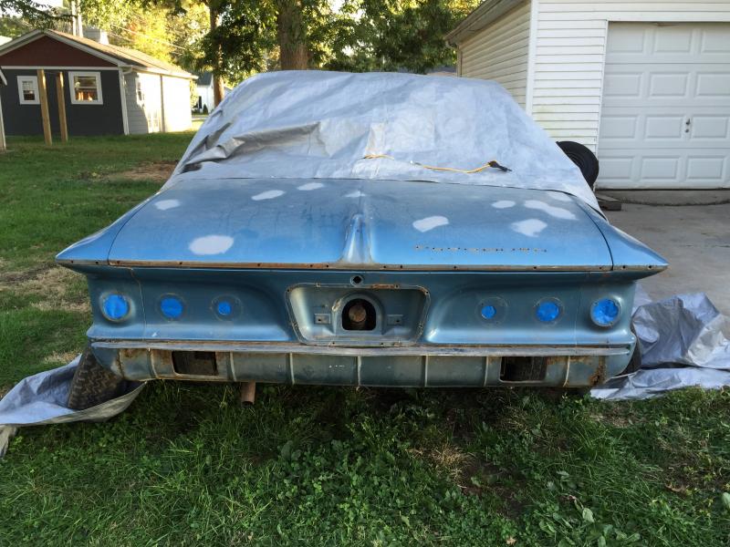

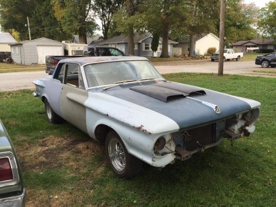

62 Plymouth 2dr Sedan Comversion- getting ready
Looks good… But I can't help but thin what kind of fun you could've gotten into leaving the back door on the passenger side, could've had a rare 3 door, lol…
She's now a 2dr
Did some more blocking and primering on drivers side then finished on passengers side. Now time to strip off the rest of exterior trim and get car ready for massaging and paint.

Your doing a great job ,can't wait till its painted.
Btw how is it titled now? Is it registered as a 4 dr or 2dr? (sorta like a trans gender)
Lol...it's titled as a 4dr. Not sure how thatd work to even have changed? I know color change is easy but this is little different.

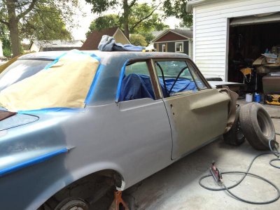

Stripping of trim. Time to start sanding down and fixing the small problem areas on rear valance.

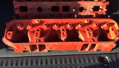

Merry Christmas to me :)
Been picking up some of my driveline parts. Have had a pushbutton trans completely gone thru and high stall built for early trans. Have a solid 440 lower end build and picked up the crossram awhile back. But scored this excellent pair of stage II Max wedge heads today. They've been sitting on a shelf for probably 20-30 years but still great shape. Have had hardened seats put in, new guides and more done to them, painted to protect and then put away till needed... Or in this case, sold to me for my project.

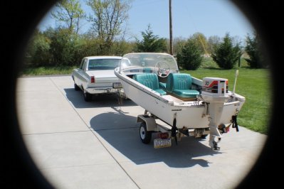

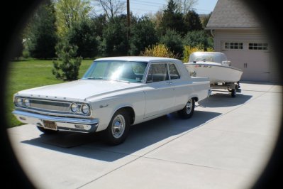

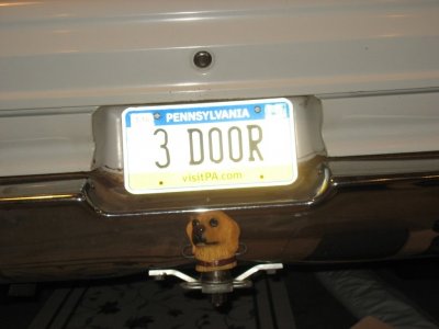

Here's mine I did it 3 years ago. I tell people at shows that it was a Calif taxi. I put a magnetic TAXI sine on the roof.
There is no way anybody can tell it was ever a 4 door.
I decided to go the rest of the way and am looking for a 64/65 sedan door, I have the quarter.
That's a matching 14' 1962 Chrysler runabout boat, with a 30 HP Chrysler engine.
Pa. plate on my 65 Calif. rust free Coronet.
