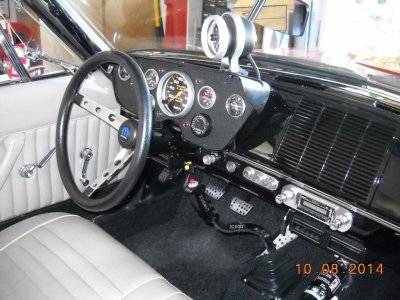

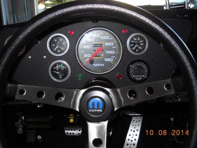

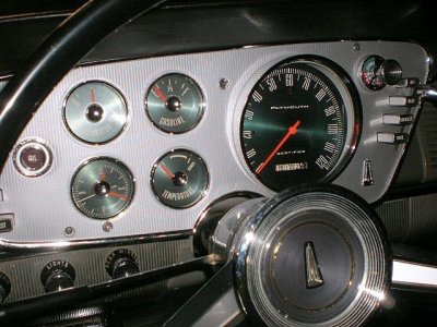

Do what I did, I used one of my 64-65 fiberglass dashes and used the 65 Belvedere gauge clusters , a shifter delete plate and a heater delete plate. It looks great in my 62 Plymouth wagon called "THUNDER WAGON'. I am Sled City Fiberglass and I make all the fiberglass that you need. Fenders, hoods, front lower valance, trunk, tailgate, and bumpers.
You probably just need to replace the little Voltage regulator on the back of the cluster. Its has three prongs that plug it in. If the bezel is good you could paint it silver for now, and have it restored later.

I put a '62 dash in my '63 years ago preferring this over the bold ranch gauges. I had the dash rechromed and installed a tach in the spot for the clock. After 15 years the dash is looking skanky peeling and dull so considering rechrome again or other options I've not explored yet. Yeah looking for ideas. I see a lot of neat upgrades but want to stay closer to original look.
