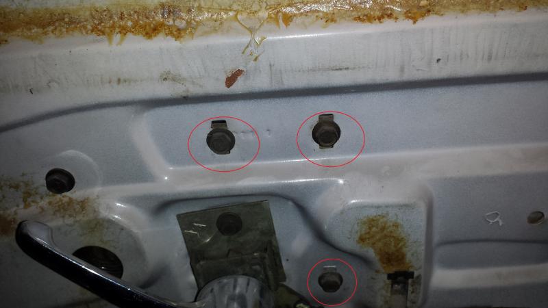

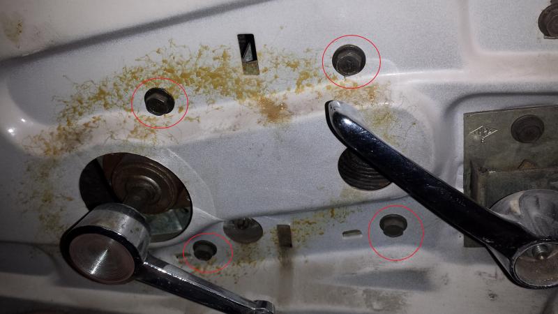

1. Remove all interior hardware on the door to get at the guts. Once the door shell is revealed you will see 7 bolts. These hold the regulator to the door.

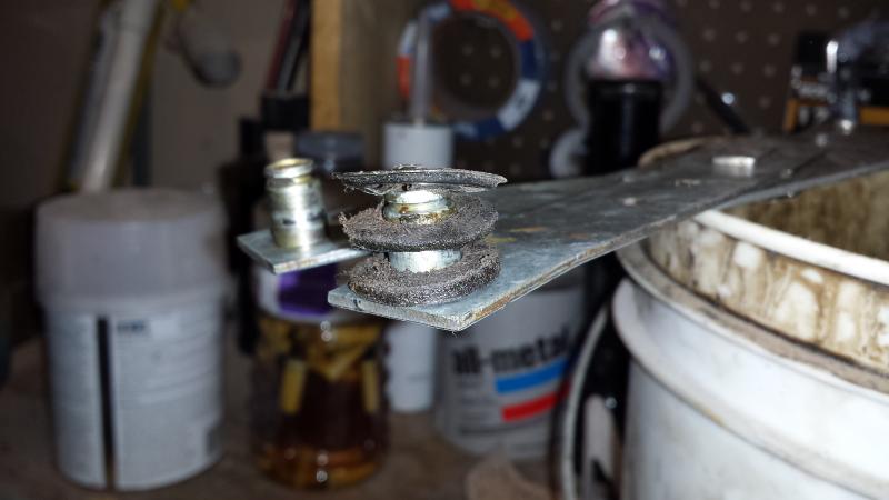

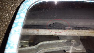

2. With the window rolled down just above the access hole in the bottom of the door, you will see the regulator arms that attach to the window track. There are 2 snap washers that need to be removed but they are on the back side (I had to use a mirror to see them). I popped the washers off with a small flathead screwdriver. There is a plastic washer on the front and back of the regulator arms for each window (total of 4 per window, these are reproduced as i found sets on ebay).
3. With these popped off I pushed the pin back towards the inside and moved them down below the window track. The window is now free, kind of. I couldn't get the darned thing out. Sooo...

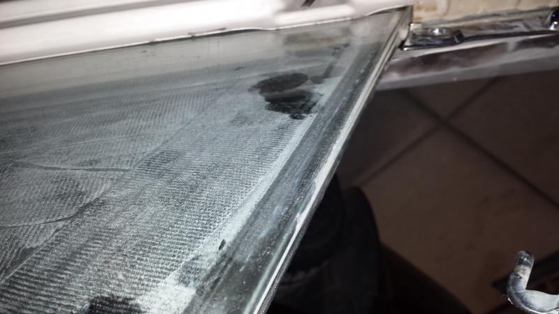

4. Remove the 7 regulator bolts pictured above. This did the trick for me as the window slid out of the track and I lifted it out the top on the interior side of the door frame.

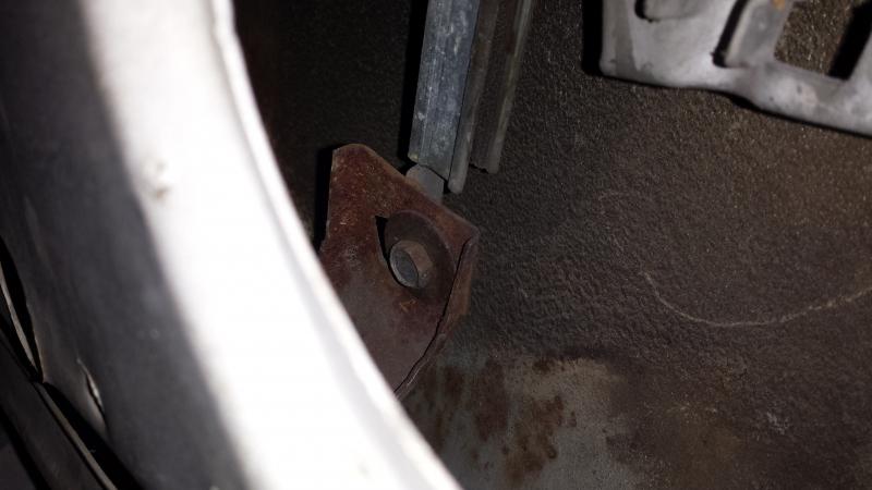

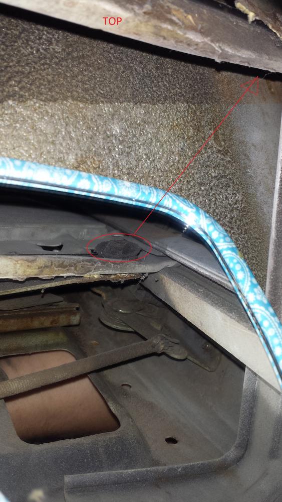

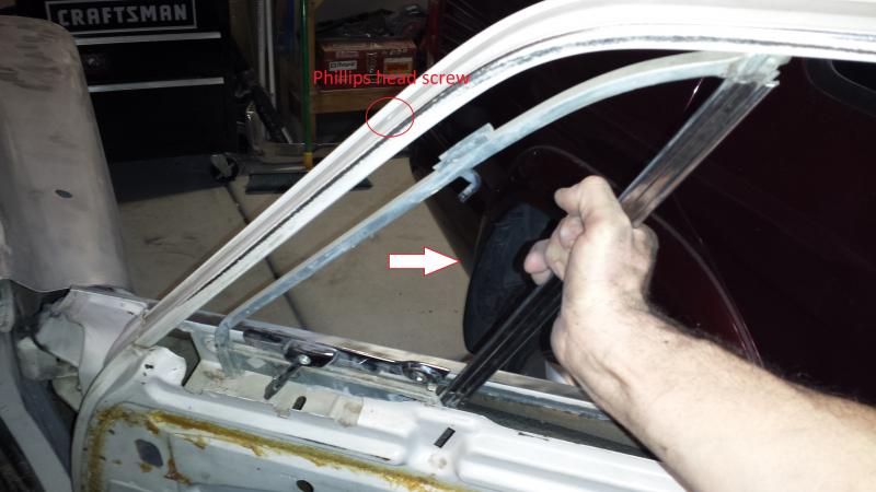

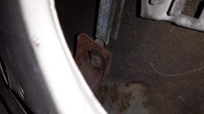

5. Remove the lower bolt on the front vent window frame. It is attached to a welded in bracket on the bottom. And also remove the single phillips head screw on the top of the door frame.
6. The vent window frame is now loose. Pull it straight back, you may have to wiggle it a bit, and then remove.

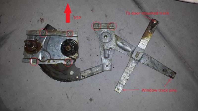

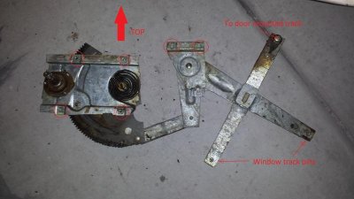

7. You can now remove the regulator and all its' dangly pieces through the access hole in the lower section of the door. For me it took some maneuvering and cut up hands before it came out.
To install it, I took a picture of its orientation in the door so I should be able to get it in right.

2. Lift window out inside top of window opening.

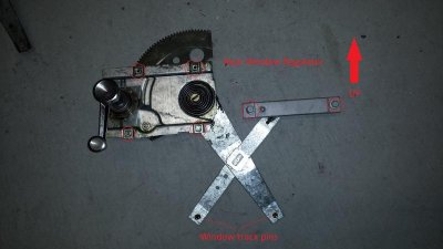

3 Remove 6 regulator screws ( The rear 2 actually hold the regulator arm track to the door so remove and slide bracket off of regulator arm).
4. Slip regulator assembly out of access hole in lower door frame.
