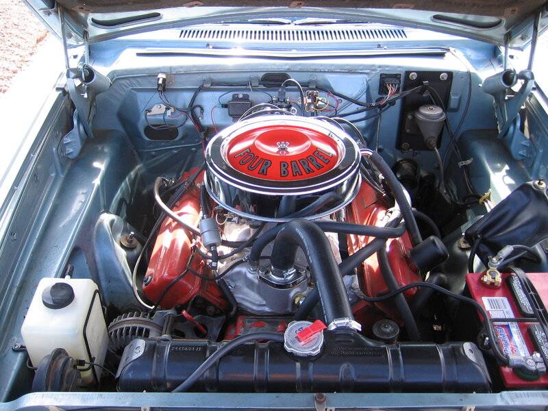

This photo is of a 64 Dodge with the early pump/brackets on a poly.That is known as a Federal pump(large fill cap) I think they were used up until 69 or 70 I don't know for sure.Later years were Saginaw pumps(small cap).

So those years may work. In the photo you can see the universal joint on the steering shaft that was cut down from the manual box steering shaft.Check with a company called Bergman Autocraft for that joint.Bergman also has complete kits and or other parts such as correct hoses.
Same. That's what is on the car in the photo.

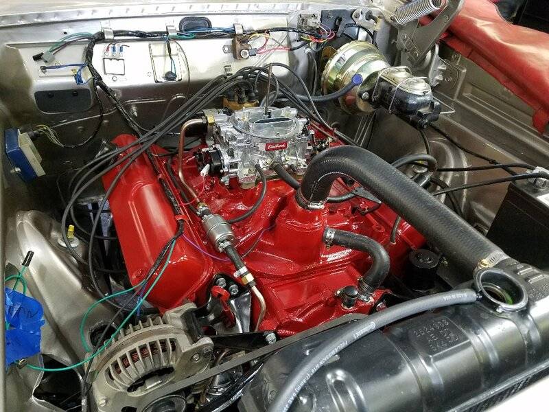

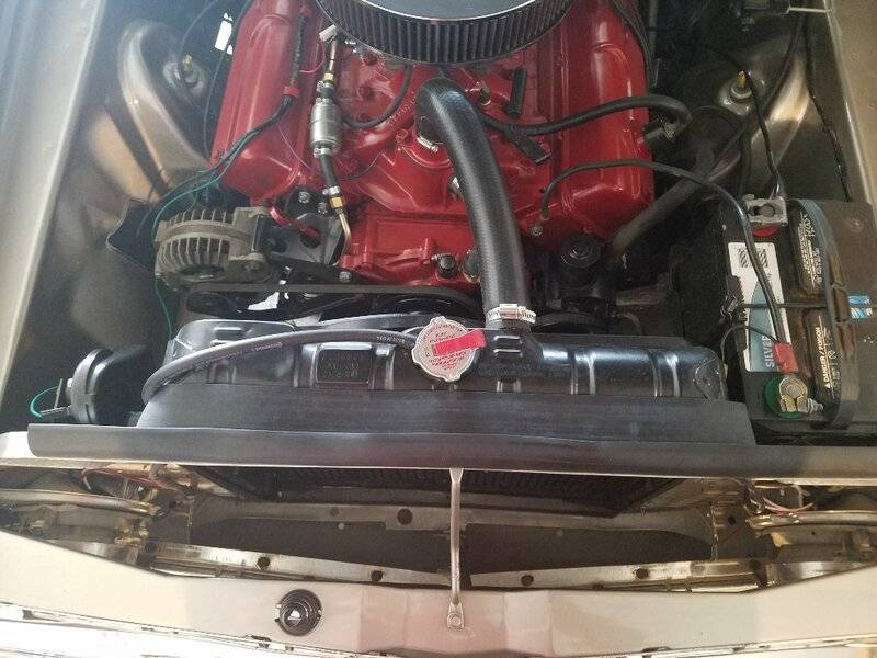

Beaut motor...at a glance thought I was looking at mine. Photo was from about 2 years ago, have since put in new BH (needed it bad), some rewiring, top seal for radiator as at the time was dealing with engine heat problems. I see you have holes in the top frame of radiator for this. Mine didn't so had to drill holes for this.

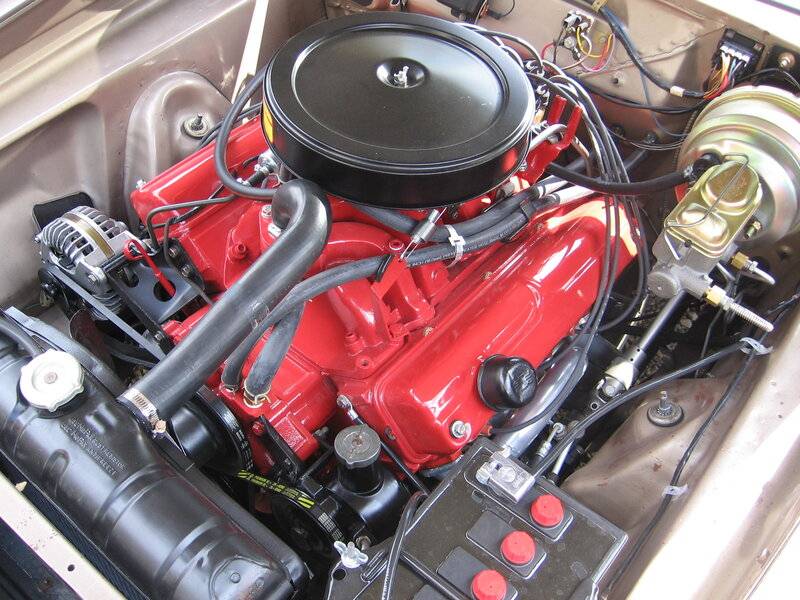

Yep some do, some don't.Photo of my 64 Plymouth no holes. My 65 Slant 6 car has holes.

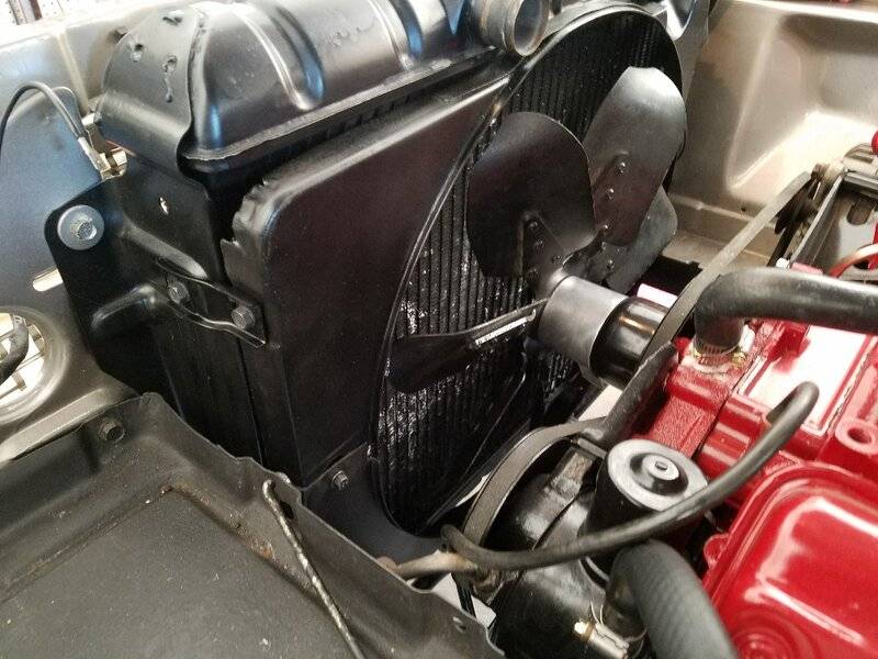

Seal was a tip I got from ColoradoDave in my hunt to reduce the motor overheating. Added a 7 blade and oem shroud I got lucky getting it cheap refurbishing it, reduced the ratio of coolant and added...well...an additive. Whatever...got the temp down. Photos of shroud and seal install.
