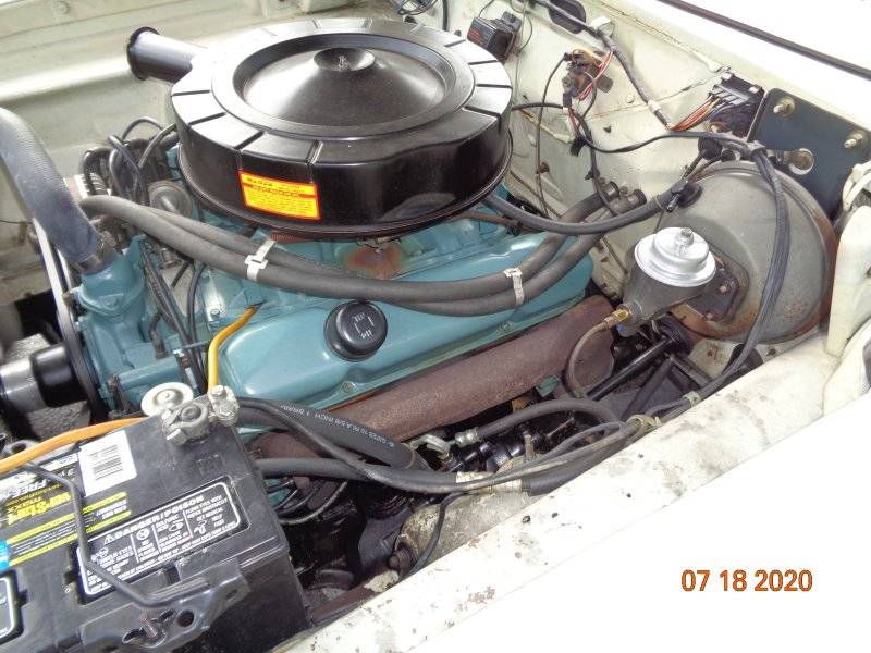

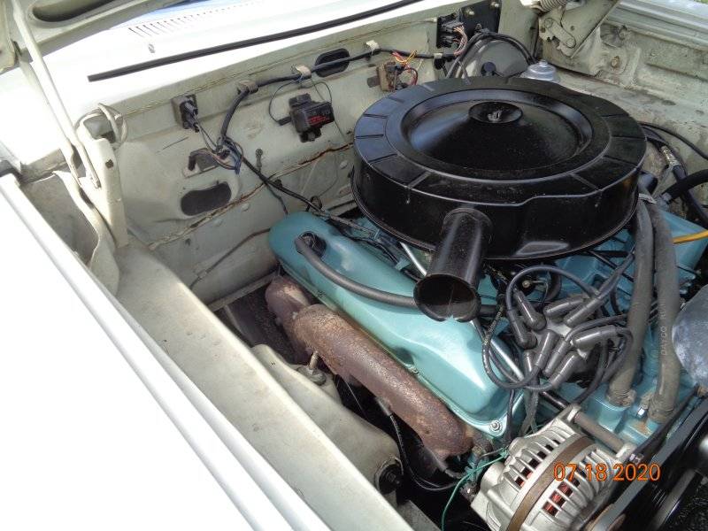

I have looked all over (Jegs, Summit, ect.) for correct fitting down pipes for my 62 Polara. Here's the deal: I have a 1971-383 in the car. I just bought a set of 1968-69 H.P. Exhaust manifolds to replace some rotted old headers on it and I would like to hopefully find a set of down pipes to bolt on and begin to build the exhaust system all the way back to the rear bumper. If someone has the "magic formula" for this, please send me pics, part numbers (for mufflers) and/or any company that has this available. I would like to stay at 2.5" O.D. pipe all the way back.
