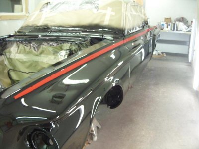

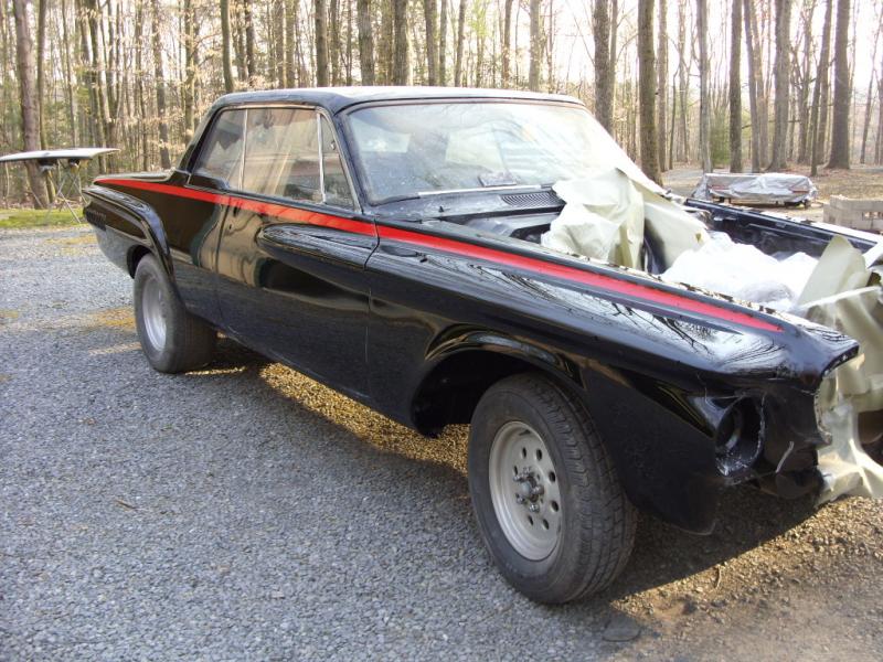

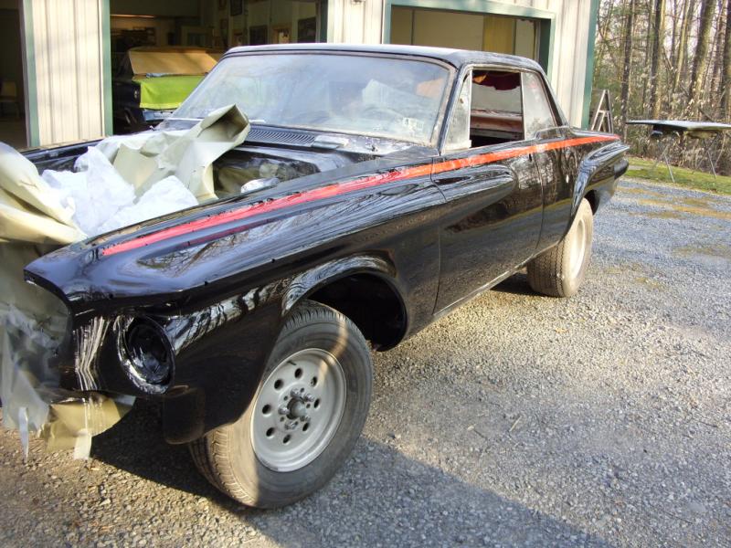

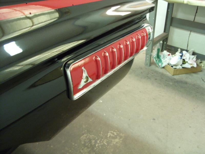

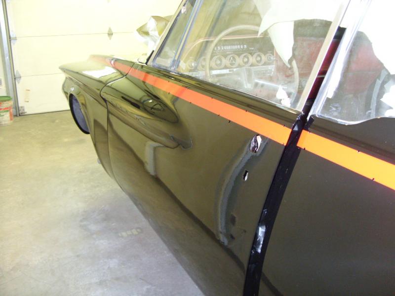

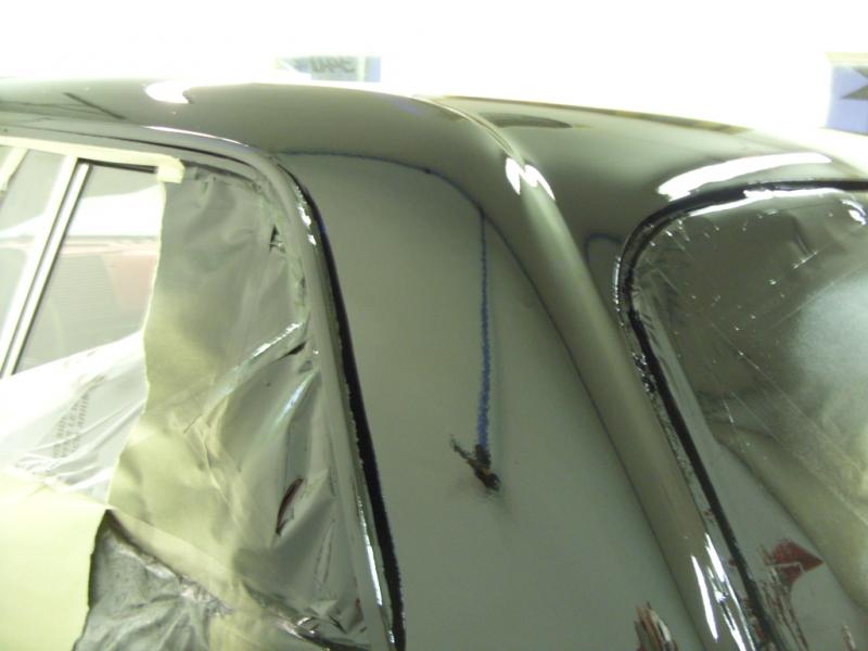

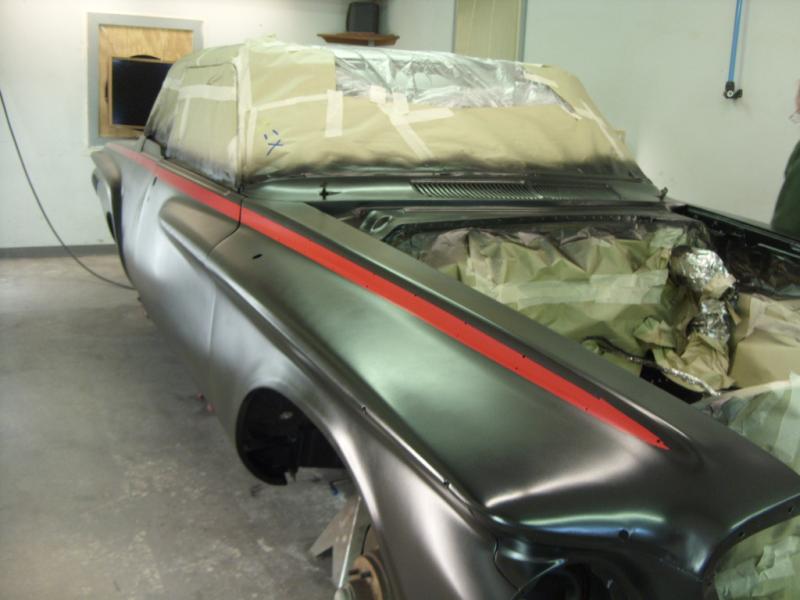

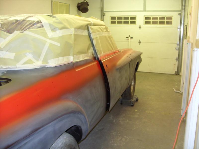

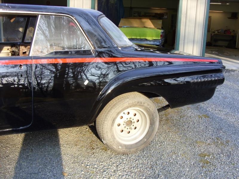

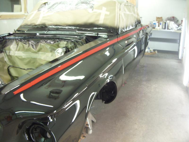

Here are some pictures of my dads 62 dodge polara 500. I did a lot of body work to it. I sprayed 3 coats of clear on it, then block sanded it with 800 grit. Then I sprayed 3 more coats of clear. I will sand it with 1500 then 3000 with lots of buffing. He plans to build a max wedge clone.

Finally got it wet sanded & buffed. Block sanded w/ 800 then wet sanded it w/ 1000. Finally DA sanded it w/ 1500 then DA wet sand w/ 3000
