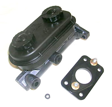

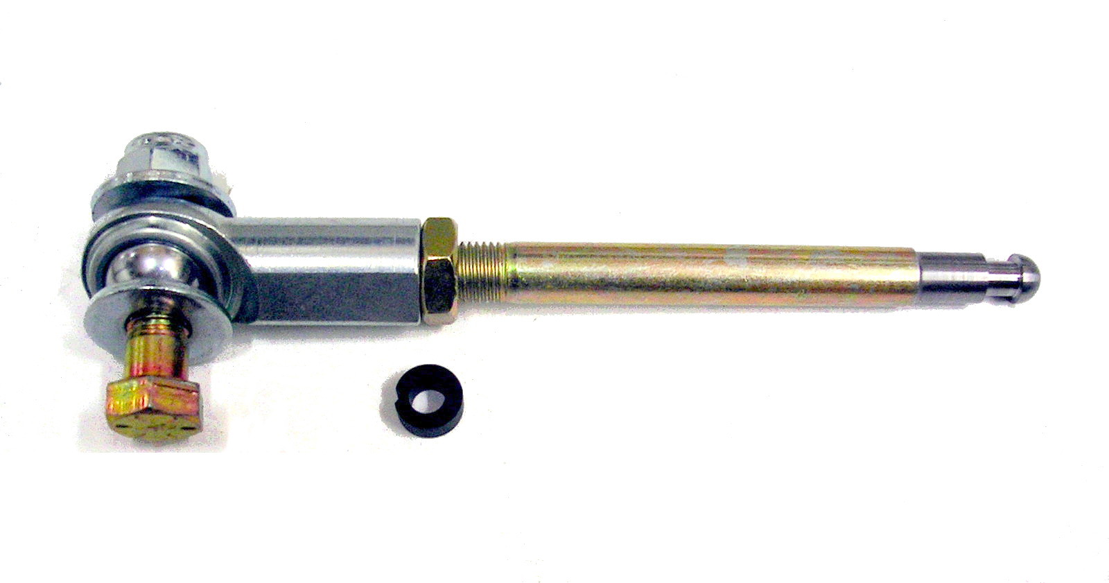

ok.... on the master on the 62... what master and rod do i need for the non-power disc. IE 64 C/B body?. and can the power brake firewall plate be made to work or am i going to have cut the plate off a non power car?
And the plate on the engine side of the firewall? that unbolts.. not sure bout power vs. manual.. my car started as a manual. Also make sure the brake pedal arm has the pushrod in the top hole or you won't have the proper ratio and pretty much no stopping..
Get the smaller bore Master cyl... i went through 3 so far and am still not too happy but the 15/16 is the best yet..
You can also email drdiff and tell him what you wanna do.. he's great to deal with
