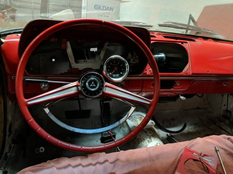

Finally reassembling the 440 wagon. I had the dash harness out as well as the instrument binnacle. I had removed this without removing the steering wheel years ago and don't remember which order I dismantled it in. Do you attach the harness switch connectors and lamps to the binnacle first then feed it into the space by the steering wheel support and locate the harness in its clips ... or is there a way to have the harness in place and connect the switches and lights to the instrument cluster with it just a little out from the dash? Anyone done a '63 Dodge instrument panel recently?

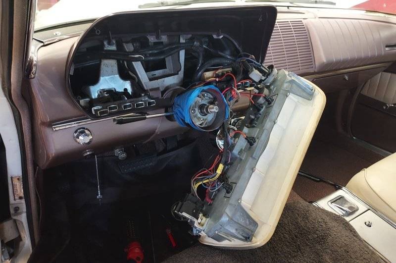

'62 isn't much different if any. I would think you would want everything in place then hook up the cluster. I never had the wiring harness completely removed but have had the cluster out several times.
Great shot ... just what I needed. I think the steering wheel has to go ... thanks!
