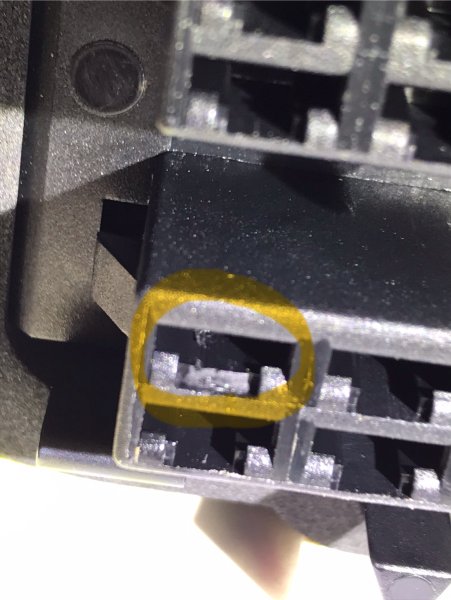

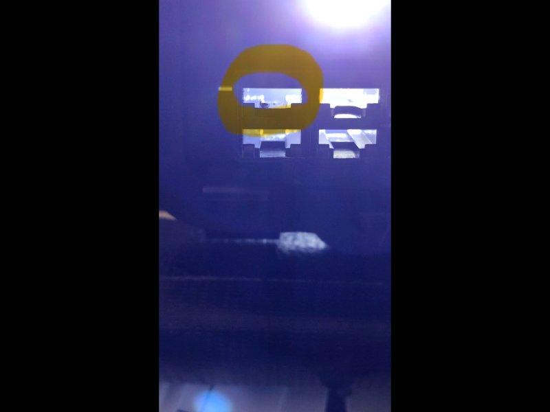

Well my mostly bad luck continues. The reproduction bulkhead connector I received has a bad terminal port in one position - appears to be a bad plastic molding but who knows. Tried to get a terminal to lock into it for 15 minutes and finally got a strong light to inspect it and the grove making the lock stop is missing. Classic is going through their lots and probably contacting the supplier. :cursin:

Those spares are the plugs on the engine side, not the bulkhead block itself. Wish I did have a good, spare bulkhead block. On hold until Classic Industries reports back.
Jeez, gave Classic over a week to see if they had any replacement bulkhead connectors that weren’t defective like the one I received. After 4 or 5 calls and no progress I gave up and sent their garbage one back to them. Ordered one from Kramer who said theirs are made in the US for a nearby harness replica manufacturer (someone different at least).

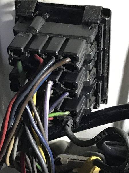

Well, finally success (I believe). The new bulkhead from Kramer looked like a quality piece and that’s where anyone who needs one should go. I decided to replace the female terminal on the big black wire from the alternator as even after cleaning it looked a little worse for wear. All the terminals locked in good and I tested them with a male terminal to make sure. I used copper67’s idea of looping a string through the upper clips to help pull it through the firewall and help snap it back in place after I got it hanging on the lower clips. Good idea.
