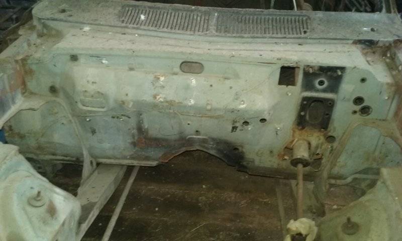

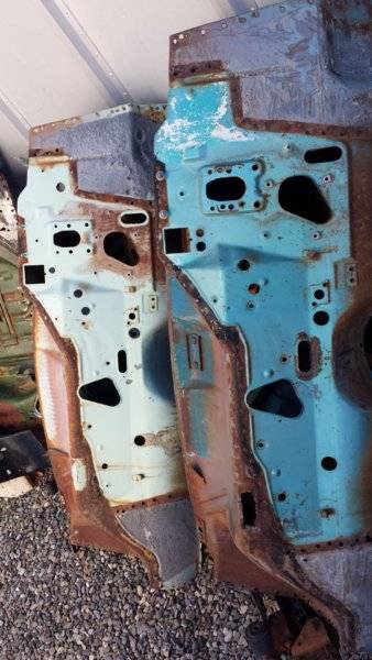

Anybody know if a 63 Dodge Polara firewall is the same as a 64 Dodge Coronet firewall?
I believe the steering column opening area is different from 63-64 or maybe it's 65 I'll have to look but that can be easily changed.

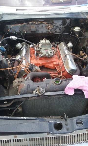

the one pic with a motor is a 64 dodge the other is a 63 dodge

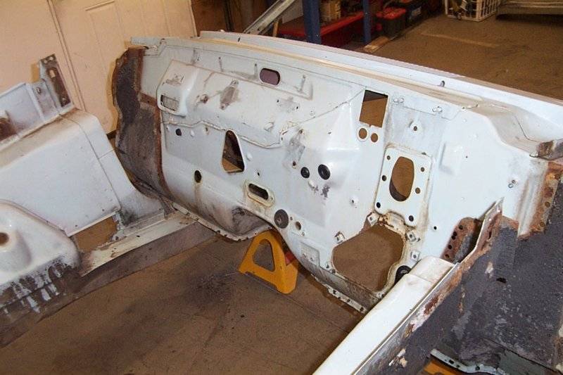

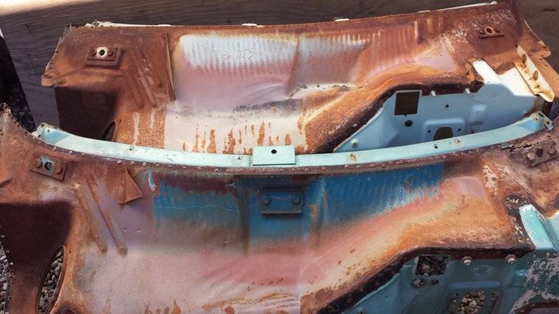

There 3 firewall/cowl units. 62/3, 64 and 65.
65 was the first for the column shifter thus it has a larger column hole in the wall otherwise is the same as 64.
Difference between 62/3 and the later ones is more on the top cowl section. The wall section is pretty much the same as the later ones.
Here is a 63 lighter blue and a 64, darker one together.
Then a 65 by itself.
