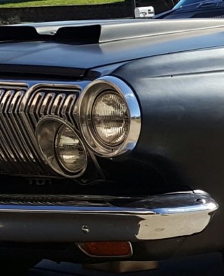

Here's what you can do with the 64 rings. You can still find these with nice chrome. I still have a few extra sets.
Compare to the pic above this post, these are an easy alternative

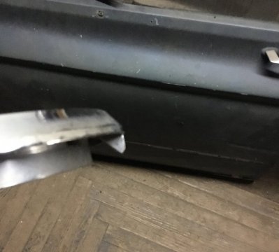

Fits the round edges of the fender like it was made for it. Just grind off these three tabs.
