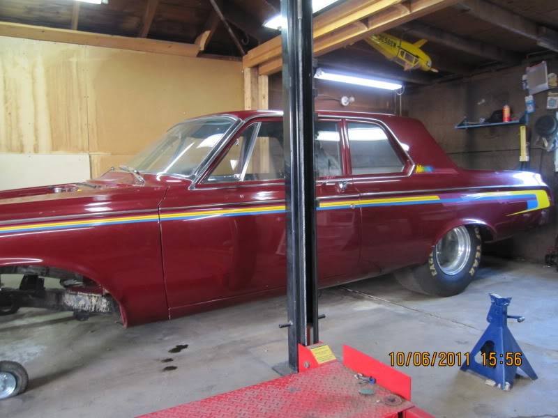

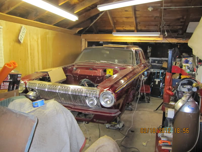

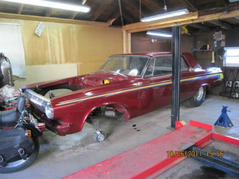

here are some pics of the 63 Dodge sitting in place..its now up off the floor on movable jack stands..

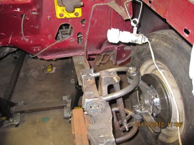

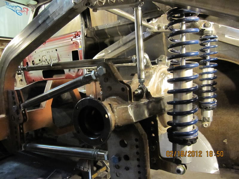

I also have a complete AlterKtion front end assembly that replaces the stock K member and suspension..has tubular upper and lower control arms on Heim joints and uses coil overs instead of the torsion bars plus it has rack n pinion steer
at one time there was a straight axle installed..

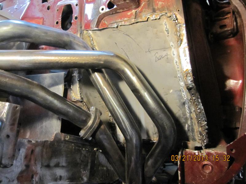

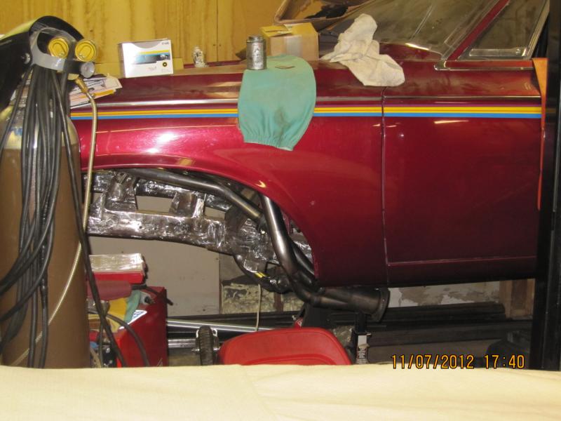

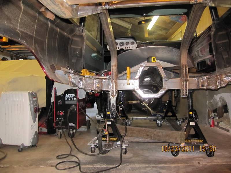

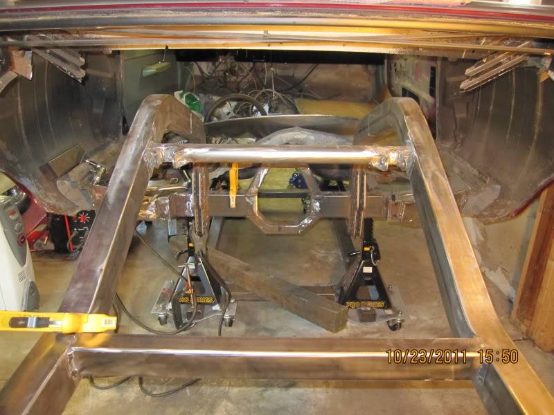

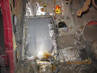

I've been working it the last few days...welding, grinding, measuring, welding some more....started to fit the wheel tubs in...been 11 years since I bought them and finally opened the box up..also have the aluminum interior and trunk panels that need to be fitted...but thats later

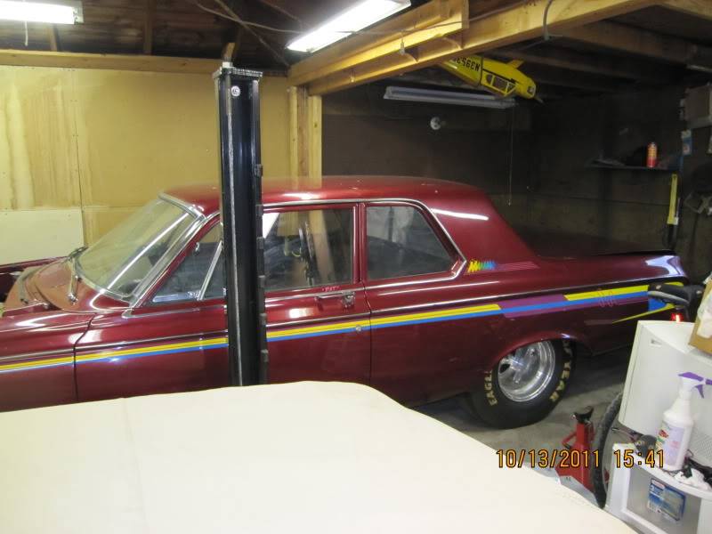

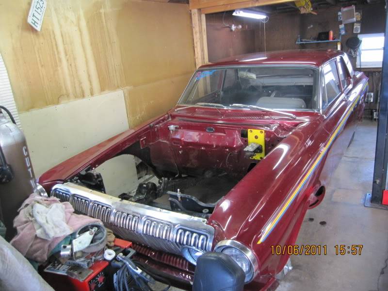

I took some pictures showing some grinding and sanding of the surfaces as I left them back in 2004..

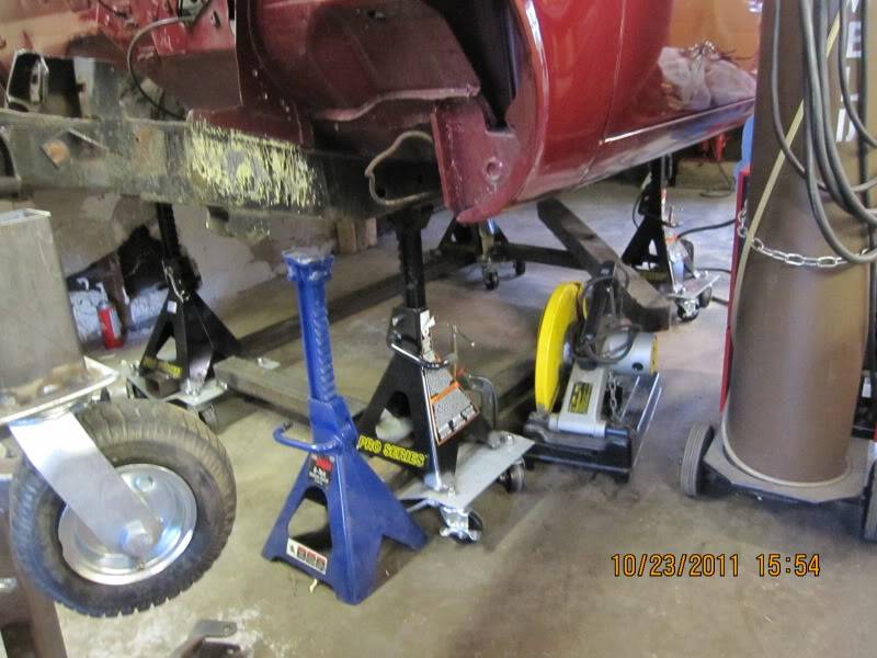

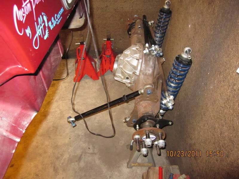

I took the 9 inch out and as you can see I jacked the car up so I can get under it allowing me to move it..

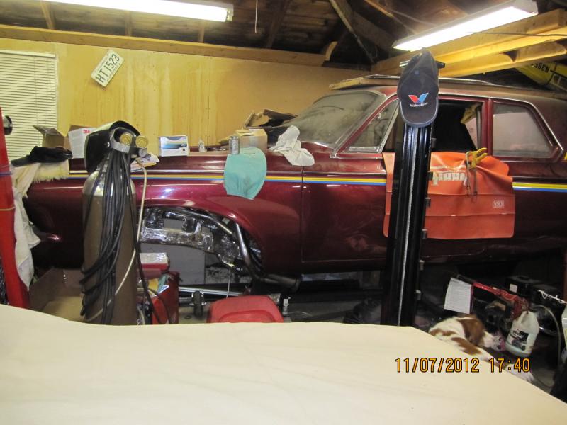

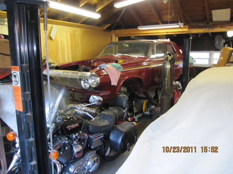

and pics of a crowded garage..

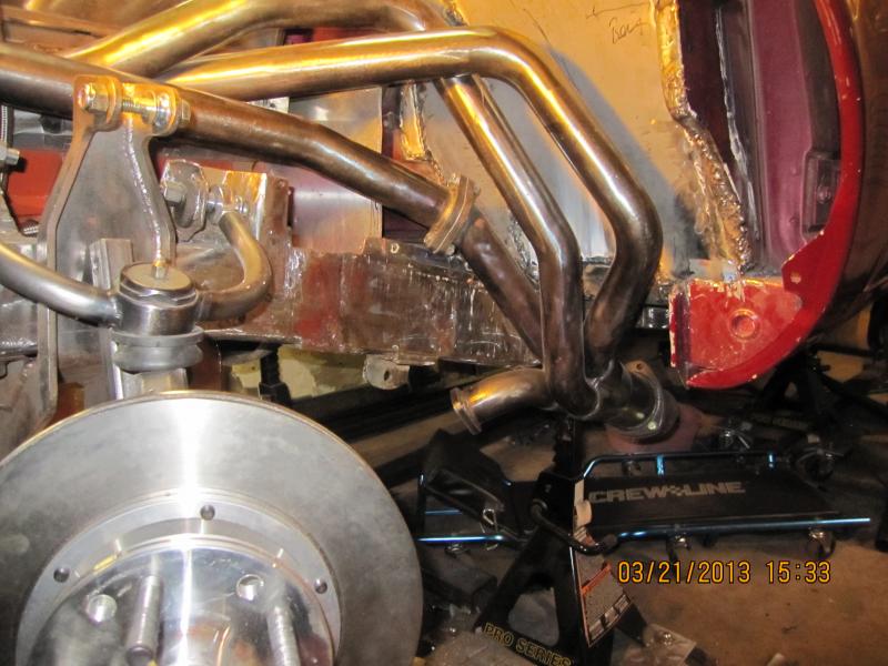

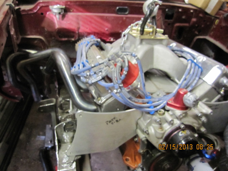

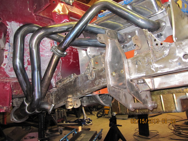

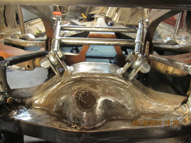

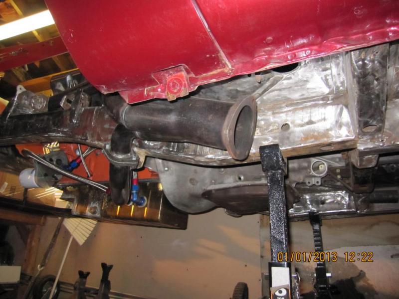

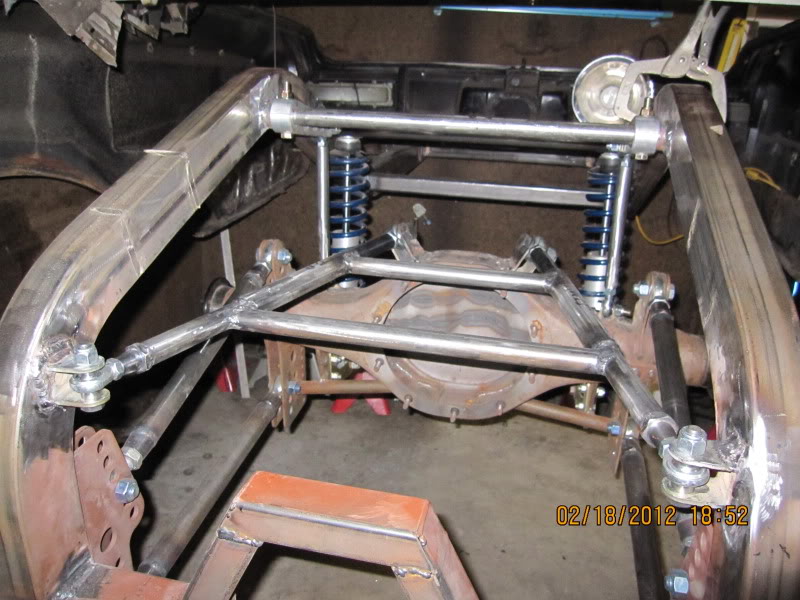

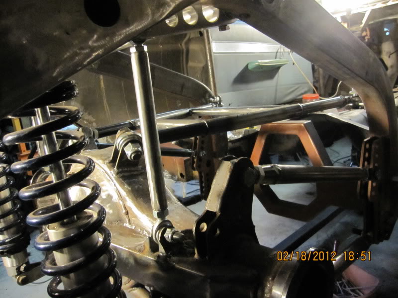

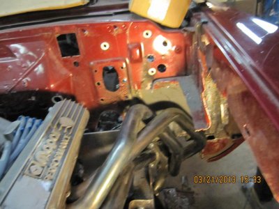

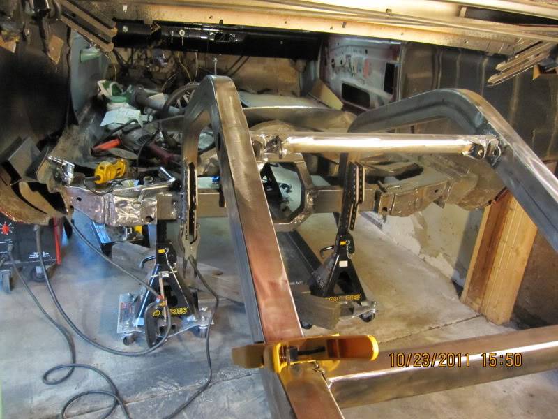

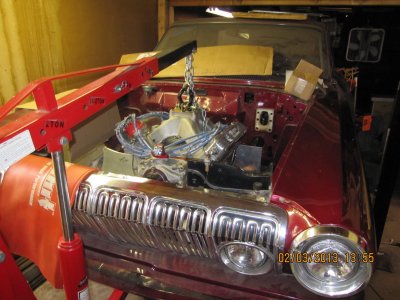

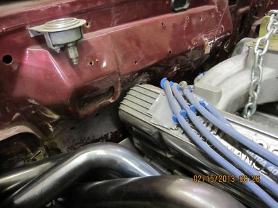

I haven't been able to work on the 63 Dodge for at least a year due to multiple surgeries..what I have done since posting is, the engine is set back 6", started bending up roll cage...the rear is complete...pictures do the talking
more
"TAMELESS" from back in the day for those that may have recognized the name
