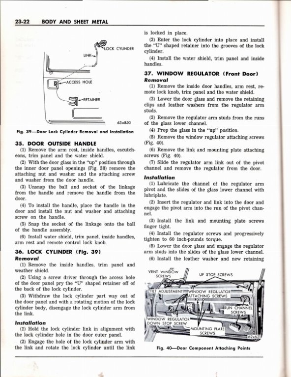

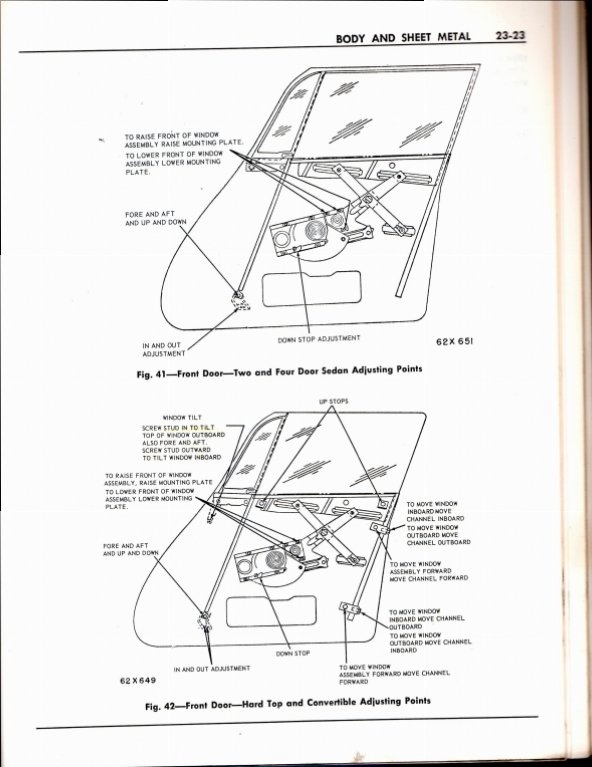

I bought a 63 fury and it doesn't have the front window regulators installed,i have a set,wondering where I can find a diagram or info on what else I need for this install,parts and pieces,john
John,
From the Factory Service Manual, a BEST buy if you work on these old cars;
