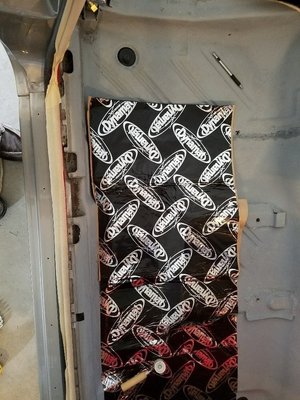

Correct, having done same thing some years ago the outboard holes match fine, I had a buddy tack-weld in the inboard brackets as you can see in the pic I took about a month ago while dyna matting the floor. I can't remember where I got the brackets but got them from someone and maybe someone on the forum could have them. Suppose they can be fabricated easy enough. Have to work off the bucket seat mounts for inboard hole location jus squaring up to the outboard holes...

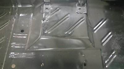

Here are a couple pics. The dimension from the rear floor seam to the 1st hole is 10 1/2". Center to center on the inside holes is 10 1/4". Center to center width wise is 17 1/4" measuring from the center of the slot. My car is a 63 Polara 500.
