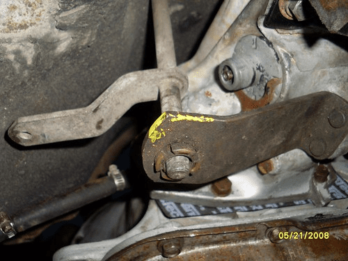

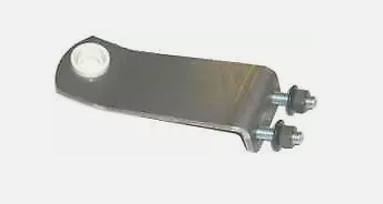

I'll see if I can find a picture. Many 727 transmission tail shafts did NOT have this boss on them. It is near the speedo gear and has two holes. In these two holes bolts a L bracket that has a nylon bushing. The shaft of the console shifter goes through this.
My explanation above is probably poor. I'll try to find a picture...
Edit: Here is the bracket:
Not a great picture, but best I could find for now. This is how it bolts in
I would think a 67 has the holes for that bracket
Ok, Thanks. I'm gonna check that today.

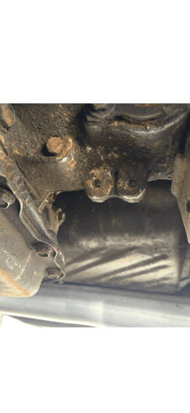

You mean these holes?
That's them. The car transmissions had them, the trucks did not.
Yup, you got 'em!
Now all you need is the bracket. It's available if you look it up on-line and not very expensive.
I'm pretty sure the parts car will not have it. Year One sells the whole kit and Kaboodle for like $95.
