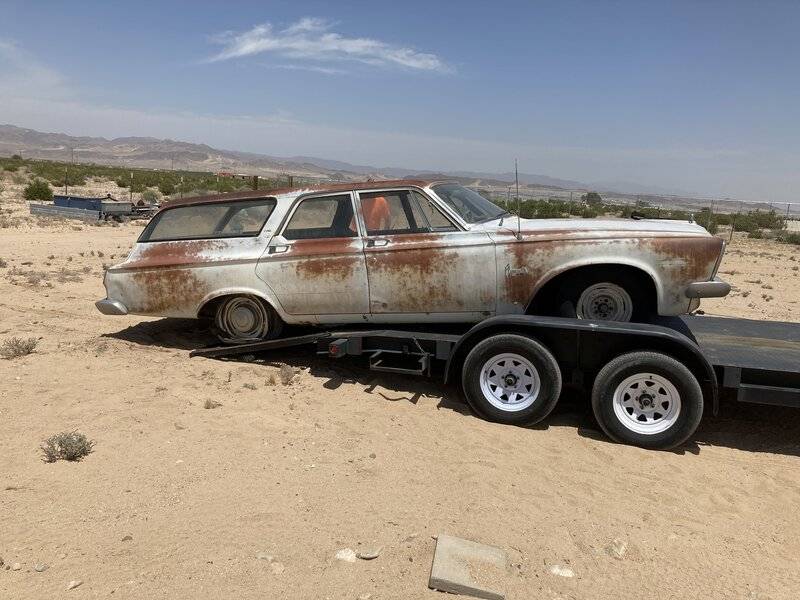

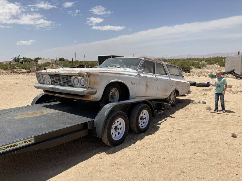

Is there a neutral safety switch on a 3 Speed column shift Station wagon ? when i turn the key i have Nothing, but if i leave the ignition switch on, i can start the from under the hood.

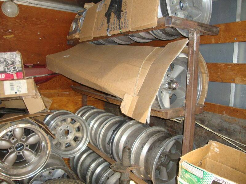

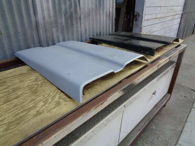

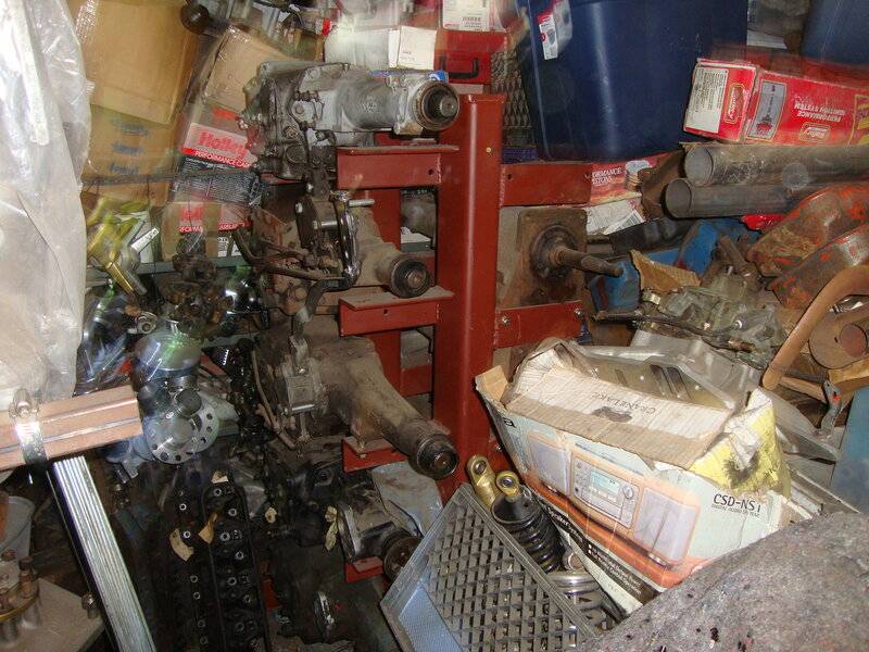

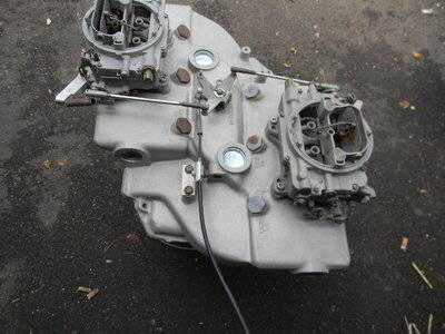

jesse , i'm just half dumb , i thought it was a talk about a stick and not an auto from the beginning . i did know of the clutch deal on 70 up . but we were talking 63 . i'm putting together a 63 stick car , but using an a833 init . and it being converted from an poly/auto to mw/stick w/vintage torq thrusts , so there is a wiring change and or a relay replacement . stick cars had a ground builtin on stick cars until 70 . i'm right on this correct ?

Dude Badass car !! Love that 63 !! Ill post pics of my wagon when i have a chance !
