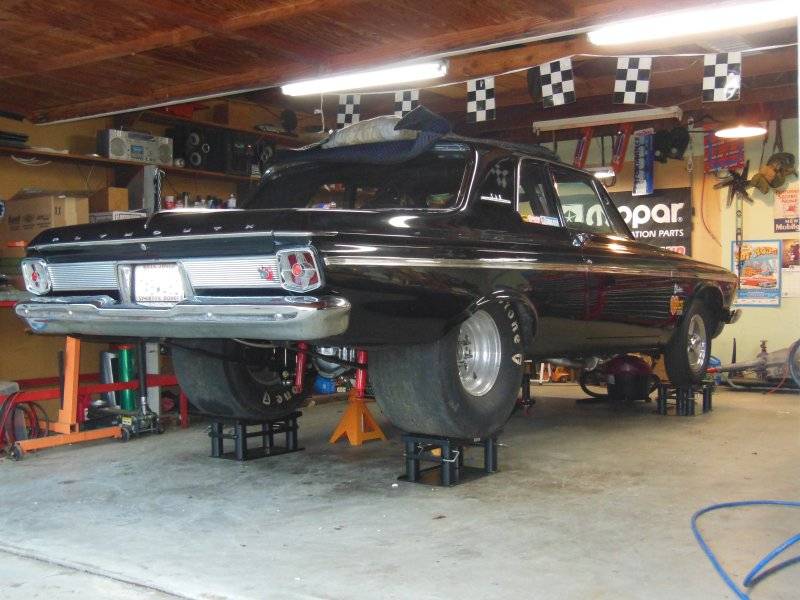

I run a 10x 28.5 slick and a 255/70x15 (29" tall) on my 62, but I've got the axle moved back an inch. I can run a 30x9 easily.
I can run a 29" tire on the front too (previous owner ruthlessly trimmed the front edge of the wheelwell).
A 255/70x15 is recommended for a 6 1/2"-up wheel (mine are on 8s), but I would give them a try.
Other choice for a tall tire for a six inch rim, would be a 235/75x15 29"tall (I have them on the front, on 7s, but like I said, my fender has been Trimmed!

Pretty much, yeah. A taste over 29" for the 255, a tenth of an inch under 29 for the 235.

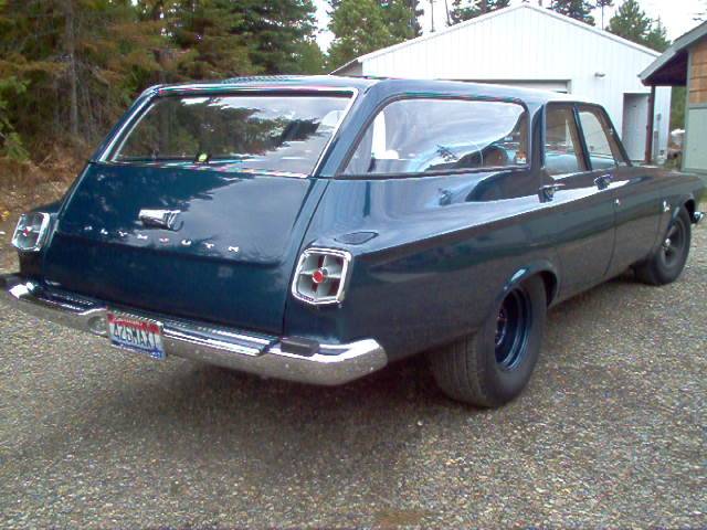

I put 285/70R15s on 15x8 4.5BS steelies on my '63 Savoy wagon - tight but it worked.
I narrowed the rear axle a bit, though.
Yes, the front wheel openings interfere with tall ft tires, more so on early Bs than later Bs.

I wanted to run the 285s on my 15x8 steelies, but they only have 4" backspace so I wimped out and got the 255s. 4 3/4 b.s. would have worked great on my car.
