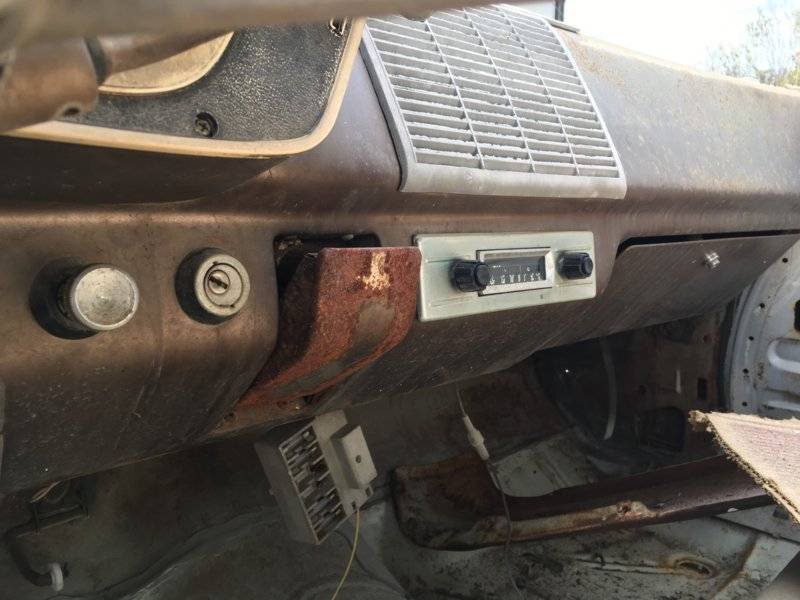

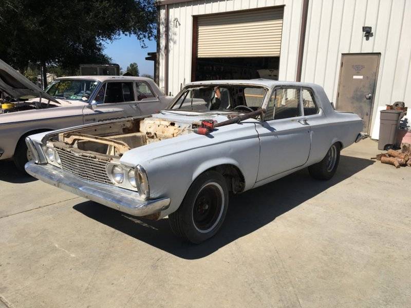

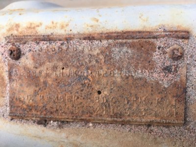

having trouble finding any interior codes for 63 plymouths. I have acquired a 63 savoy and was curious what color the interior was originally. The fender tag is hard to read but the code is either 333, 363 or 383? I don't have the car in my possession yet so I can't yank the fender tag and look at the back. By what's left of the interior, I'm guessing it was a tan bench interior. Anyone know these codes?

Sort of Vandan. I'm starting to figure out that maybe the interior codes aren't easily deciphered from reading some articles. That trim code should be the interior color, I'm guessing.
Dash paint. Seat covers. Door panels, etc. I'll keep looking.

You tag calls out a body 211 ......but 1963 Plymouth Savoy is 311 (2 dr sedan) ,there is no such code for body as 211 ??
But the Code 303 for TRM is tan cloth & vinyl (1963 Plymouth 2 dr sedan (311) & 4 dr sedan (313).
From my understanding both body model savoys (2&4 dr sedans ) only came in the following interior colours blue(301),tan(303) & ivory(306) .All cloth & vinyl
WW1 is monotone Ermine white
Thanks 1962 Polara. That's what I was looking for. Must be a typo? It's definitely a 63 savoy two door. Always has been.
