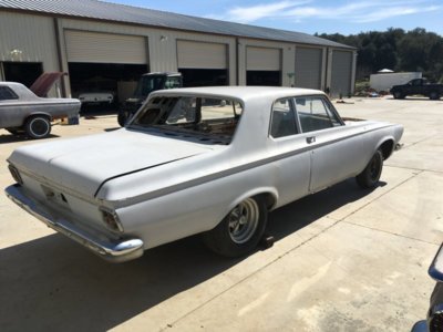

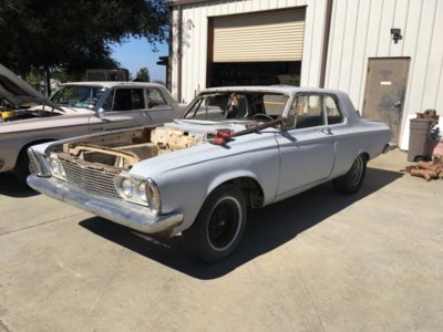

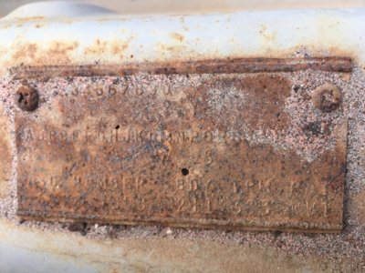

having trouble finding any interior codes for 63 plymouths. I have acquired a 63 savoy and was curious what color the interior was originally. The fender tag is hard to read but the code is either 333, 363 or 383? I don't have the car in my possession yet so I can't yank the fender tag and look at the back. By what's left of the interior, I'm guessing it was a tan bench interior. Anyone know these codes?

You tag calls out a body 211 ......but 1963 Plymouth Savoy is 311 (2 dr sedan) ,there is no such code for body as 211 ??
But the Code 303 for TRM is tan cloth & vinyl (1963 Plymouth 2 dr sedan (311) & 4 dr sedan (313).
From my understanding both body model savoys (2&4 dr sedans ) only came in the following interior colours blue(301),tan(303) & ivory(306) .All cloth & vinyl
WW1 is monotone Ermine white
Thanks 1962 Polara. That's what I was looking for. Must be a typo? It's definitely a 63 savoy two door. Always has been.
