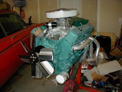

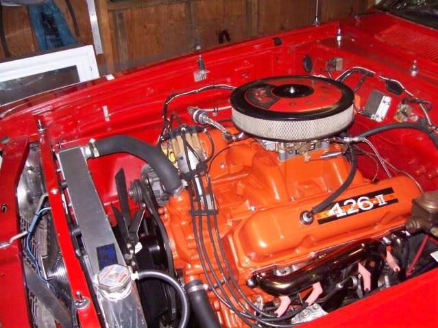

These are Hedman Elite, going into a 63 Dodge.

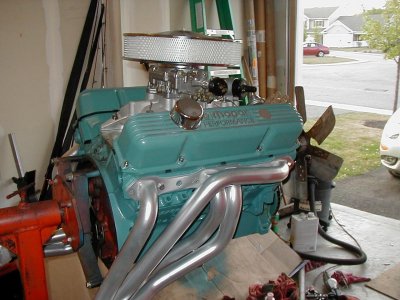

These are 2" TTI's I used with my new eng. They fit great and work great. Ron
These are 1-3/4 Hedman Elite that I had on my old eng. They also fit fine and worked good. I will say the TTI are a better quality header but there is nothing wrong with the Hedman. Ron
