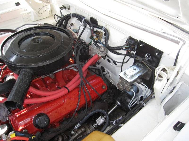

I purchased a 1966 B body MC on Rock Auto, for less than a single cost. It bolted on but, as I recall I epoxied the original studs into the new MC as the holes were larger. That worked great. I can lock up the drums if need be.
Mike
Mike
That looks like a drum/drum MC though isn't it?
