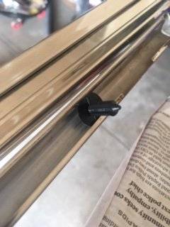

Not able to find anything specific to a 63. Looking at alternatives does anyone see a reason this late model plastic clip wouldn't work? It fits in the channel and the body holes.
I dont think you will be able to get it tight. The head will push into the trim and leave it loose.
They seem to work but don’t “pull” the trim into the body as tight as the spring clips do.....
