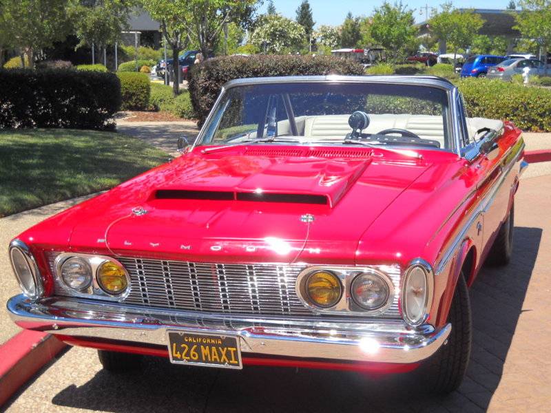

Could someone give me the measurements of the low profile hemi scoop, length, width, height in front and back. I have the wild hair to fab one out of aluminum or light mild steel. It will just go on a 62 Dart more door for the fun of it all. Thanks

Not to burst your bubble, but this style of scoop looks easy to make to the naked eye, but it is harder to fabricate than you think in order to look correct.
It might be easier to just get one from Mancini or Jim Kramer.
I made mine out of aluminum years ago against all odds and no such thing on the market, but it was a mission.

I have had some nice fiberglass ones years back made by SledCity. I just rather have the dimensions than just guess-ti-mate it. HS shop class has metal brake I can use. I guess if I can fab all my floor pans, and the underhood and under trunk lid bracing, without a metal brake, I can make this scoop.
I think I an make a nice pretty cose t correct scoop and not hve $400 in it. A sheet of 20 ga. mild steel is probably $40.

It's those compound bends and rolls at the leading edges and ends that make it a little hard including that in-curved ridge on the back side that meets the cowl/windshield area. Some welding required. The narrow crease down the middle of the topside can be made with a jigged male/female press mold. I forgot all the dimensions on the low rise scoop being that mine is fashioned after the taller AFX style.
Call Larry at Sled City, talk to him. He's a Great Guy, He'll probably give them to you...

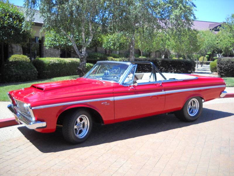

Is this what you want to replicate? If so, I will be glad to get you all the pertinent dimensions.
