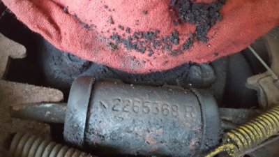

Front wheel cylinder has part #2266368R stamped into it.

BTW, I've never seen a part number so visible.

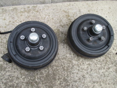

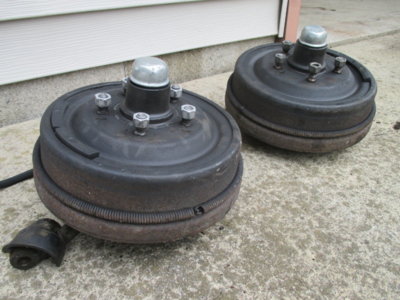

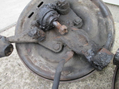

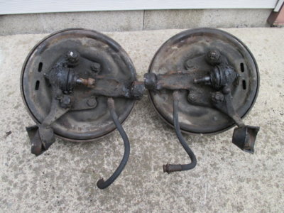

If you run into trouble with the new parts on your build, I have a complete set of front 10" drums I removed from my '63 330. They are in nice shape, and worked 100% when I took the car down. I'm going disc up front, so I won't be using them. I may keep the spindles. Car was a California car, so no winters on them...
